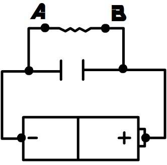

The thing between A and B is an inductor, don't know how to draw the coil :-p
Im wondering if there's AC currents flowing through point A and B?
Or is the capacitor keep charging up w/o discharging?
Or What happens??
If that doesn't charge the capacitor in the oscillator, I want to know how to.
Thanks :smile:

Charging a capacitor is using it. It charges and discharges, storing/releasing energy in/from the electric field between its plates.
Where would the AC current in your circuit arise from? You have a battery (which is a DC source) which is shorted with your wire, effectively bypassing your capacitor, which you might as well remove from the circuit---it does nothing as your circuit stands. If you didn't short it out, your capacitor would charge up with its characteristic exponential curve leveling off at the battery voltage, at which point no more current would flow in the circuit.

Look up the expression for the impedance of an inductor (L), and you'll see that it acts as a short to DC. So no, there's no AC current between A and B.
To charge the capacitor (C), remove the L (and thus the DC short-circuit), and wait until the C charges up to the battery voltage. At this point you can remove the battery and your C will contain a certain amount of energy in the form of an electric field between its plates.
If you were to connect a L over the C at this stage (when the battery is removed), the stored energy would ideally slosh back and forth between C and L (which stores energy in a magnetic field) indefinitely.
Did that answer your question??

Currently, your attempt at drawing a inductor looks more like a resistor to me. Though, I guess that's better than a straight line as you drew the first time :)
