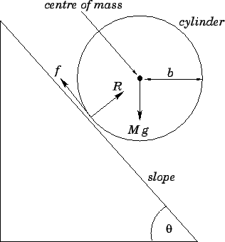

Consider the rolling cylinder in the figure
To describe the cylinders translational motion, I have
[tex]Ma=G sin \theta - f[/tex]
[tex]a[/tex] is the acceleration of the cylinder parallel to the slope.
If you have an object (cylinder or not) sliding down the same slope without friction, with the same mass as the cylinder in the figure. And if you then apply a force through the center of mass equally big as the friction force [tex]f[/tex] above, with a direction parallel to the slope upwards (so that it works against the direction of the acceleration) - will this sliding body act exactly as the rolling body above (considering translational motion, not rotational)?
Why not?
Maybe because the fact that the body is rotating will make it accelerate differently. Plus I don't find it intuitive that the friction force working on the edges of the cylinder will be as effective in changing the motion as a force acting directly in the COM. The frictional force creates a torque, while the force in the COM does not.

This is what the OP said in post #1:
"If you have an object (cylinder or not) sliding down the same slope without friction, with the same mass as the cylinder in the figure. And if you then apply a force through the center of mass equally big as the friction force f above"

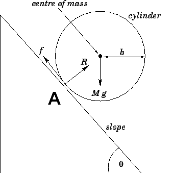

These two figures illustrate the rolling case and the sliding case respectively:
Rollin'
Slidin'
[PLAIN]http://img213.imageshack.us/img213/8353/frce.png
Let me break down my questions:
  • Which one wins the race?
  • If it's a dead race, as some here claim, then what about the KE?
  • If the opposite is true, then it does matter where on an object you apply the force (in contrast to what Doc Al claimed). Which I also find non-intuitive.
Im sorry if I have caused confusion. I hope this clear things up.
Credits go to mspaint.exe
It's a tie.
What about it? In the rolling case, the friction force (static friction) does no work, but it does transform gravitational PE into rotational KE. In the sliding case, the applied force does negative work.
As far as the acceleration of the COM is concerned, it doesn't matter where the force f is applied. But the overall motion of the cylinder is certainly different. In one case it rotates; in the other, it doesn't.

Ooh, you are going away from the right track
Let's go from the start. We have 2 cases:
CASE 1: Rolling.
In this case, let's make another assumption: the cylinder rolls without slipping, i.e. [tex]\vec{v_A}=0[/tex]. This will make things easier and concurs with what Doc Al said. Because of that assumption, friction in this case doesn't do any work on the cylinder (it's static friction!). Let's assume that the cylinder starts moving from rest.
By the energy conservation law: PE = KE = translational KE + rotational KE
This concurs with the statement of Doc Al, "some of that PE is transformed into rotational KE". In addition, friction doesn't do work, but the cylinder gains both translational and rotational KE, not translational KE only as in the "sliding" case. This is why people usually say, static friction in this case only does the job of transferring a part of PE into rotational KE.
CASE 2: Sliding.
Because now the force f is applied at the center, whose velocity is not zero, f does do work on the cylinder. Besides, we have already known that the cylinder does not rotate in this case.
Therefore: PE - (work of f) = KE = translational KE
In addition, we all agree that the translational motions in 2 cases are the same, so translational KE in case 1 = translational KE in case 2. Now do you agree with me that total KE in case 2 (sliding) is smaller than in case 1 (rolling)?
For the above questions of yours:
_ #1 and 2: Maybe you mean "rotational KE" instead of "rotational PE"?
In general, PE will transfer into any other kind of energy if the object decreases its height. The object, initially, already has an amount of PE, i.e. it has the potential to gain kinetic energy or any other kind of energy if it goes down. This is because of the law of energy conservation.
_ #3: Nature only knows static friction doesn't do any work (i.e. [tex]\vec{v}_A=0[/tex], and that's the only thing she wants. It's like an initial condition. If it's not static friction, things will change. And because it's static friction, friction doesn't do work, which leads to so many results afterward.
So why static friction? It's the nature of the interaction between the material of the ground and the material of the cylinder, and I have no answer for that.
_ #4: Now it's like you have $100. Staying at rest = no trading, the money remains the same. If you trade $100 for shares, you will have, say, 100 shares.
But if you are investing in something, buying shares for example, your money will go down as you have more shares (or more KE!). Maybe yesterday you had $101, and tomorrow you will have $99, but now, you still have $100, and you have the potential to have 100 shares if you use up your money. The same thing goes for PE. People don't call it "POTENTIAL energy" for nothing!
_ #5: If we consider the cylinder only, friction and the "f" force are never internal forces. Friction is the force by the ground, so it is external force.

What does it mean that the point of application of the force do not move? Why does it move when you apply the same force on the COM?
Doc Al said:
What do you mean by 'leaking' Potential energy? At any given height, the gravitational potential energy is the same regardless of whether the cylinder is rotating or sliding. As the cylinder lowers, the potential energy is less. The energy goes into rotation in one case or work done by the applied force in the other case.
By leaking I meant that the body was constantly losing PE, i.e PE was transformed. Anyway, I understood you explanation - see if I got this right:
(Arrow here means "is being transformed to")
a) Rolling case: PE -> translational KE & rotational KE
b) Sliding case: PE -> translational KE & internal E to the "thing" that exerts the "braking force" f
c) Sliding case without any other force than gravity acting: PE -> KE
In a) and b) the translational KE is the same. However, in a) the PE transforms to energy that stays within the system, namely rotational energy. Thus, the total Mechanical Energy in a) will be conserved - as opposed to what happens in b): here energy is being transferred out to the environment (like the book). Therefore: Mechanical Energy is conserved in a), not in b) - but the translational KE are in both cases the same! The race will be a tie.
In c) the Mechanical Energy is clearly conserved, the sliding body will gradually lose PE in favor of gaining more (trans.) KE. No potential energy is lost to the environment, or to making rot. KE. Since the trans. KE and trans. velocity are connected, the cylinder in c) obviously wins the race!
Doc Al said:
In both cases the force is external. But in the sliding case, that force does no work. Key point: Since the cylinder rolls without slipping, there is no relative motion between the bottom of the cylinder and the surface. In order for an external force to perform work, the point of application of that force must be displaced.
Can you please elaborate on this? My English isn't too good.. "In order for an external force to perform work, the point of application of that force must be displaced". Can you say this sentence with other words?
Thank you very much! I feel like I'm on the verge of an epiphany :)
The force f in rotating case is what converts potential energy to rotational.
