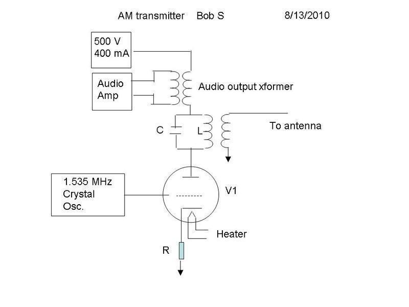

Here in thumbnail is a block diagram of an AM radio transmitter I built and used to broadcast on the AM radio band about 1958. It had a range of about 10 miles. V1 was an old WW II military surplus transmitter tube (about 8 cm diameter). The antenna was a horizontal wire in the attic, about 15 meters long. Standing waves in the antenna could be detected using a fluorescent lamp tube. For obvious reasons, I never turned it on for more than about 15 minutes at a time.
