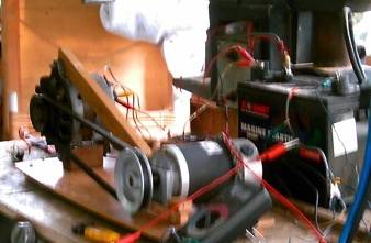

You could build a model.
Take the motor-generator I built this winter for example.
Photo of a homemade motor-generator setup on a workbench: a belt-driven electric motor with a pulley and fan belt connected to a generator, with red and black wires, and a metal frame and a battery charger nearby.
On the left is the generator. Driving the generator via a fan belt is the motor.
When the fan belt was removed, the motor consumed 200 watts.
When the fan belt was installed, the motor consumed 300 watts.
This was just drag from the idling generator and belt.
If the generator was then hooked to a 40 watt load, the power consumed by the motor would probably go up another 100 watts.
The same thing is happening in your wind driven generators.
For every watt they generate, your vehicles primary engine is going to consume more than that watt. (Unless of course you turn off the car while driving or going down a hill and turn off the car, which would be unwise as power steering and power brakes would fail and you would probably die trying this experiment)
I was trying to explain the concept of regenerative braking to someone once, and they could not get it into their head that a generator under electrical load exerts a torque. Unless that torque is countered, the generator will quickly stop rotating.
The torque required to keep your friends little hood ornament fans rotating under load is called wind drag. That wind drag has to be countered by your vehicles primary engine.
Any energy you got from the generator could more efficiently be subtracted from the wind drag of the vehicle by increasing its aerodynamics. I.e. I think removing the hood ornament altogether would generate convert more energy into forward motion than it would deliver as electricity. If you want more electricity, why not just increase the output of your alternator and take the energy directly from the engine instead of first converting it into forward momentum and then getting it back from the wind drag?
