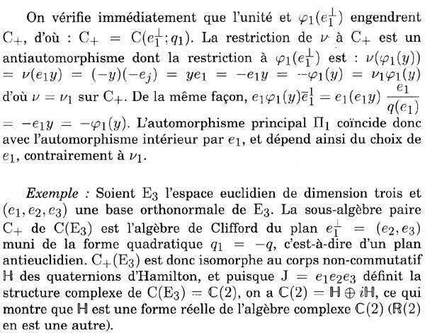

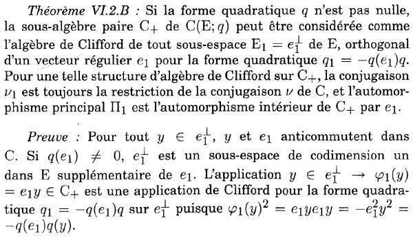

What you did is a particular case of a general theorem:
If the quadratic form [tex]q[/tex] on [tex]E[/tex] is non-zero, the even subalgebra [tex]C_+[/tex] of [tex]C(E;q)[/tex] can be, in a natural way, considered as the Clifford algebra [tex]C(E_1;q_1)[/tex] of the subspace [tex]E_1=e_1^{\perp}[/tex]
of [tex]E[/tex], orthogonal to a regular vector [tex]e_1[/tex], where [tex]q_1=-q(e_1)q[/tex].
For this you define [tex]f(y)=e_1 y,[/tex] [tex]y\in e_1^{\perp}[/tex].
Then [tex]f(y)^2 = e_1 y e_1 y = -e_1^2 y^2 = -q(e_1)q(y).[/tex]
P.S. I am using the convention [tex]C(E;q)= \mathcal{C} l (E,-q)[/tex]

Rene Deheuvels, "Tenseurs et Spineurs", Presses Universitaires de France, (1993), pp. 247-248 (Very good book. Good to have in the library.)
I have scanned for you the Theorem, its proof, and and example
