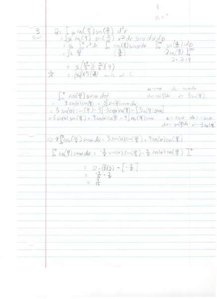

We have a sphere (radius R) where charge is placed inside of it, ρ(r)=ρ0 cos(θ/3) sin(φ/2). Find the total charge. Your answer will be in terms of R and p0.
I think I did it correctly, but I would just like to make sure I did (and thus ensure my understanding). My answer is marked by the star, and everything below it is just my integration work that was required by the problem.
I think you'll want to double check your integration of
[tex]\int_0^{\pi}\cos\left(\frac{\theta}{3}\right)\sin\theta d\theta[/tex]
Hmm I tried to go over it again and I got the same result. Was it somewhere on the first integration by parts where I messed up? Thanks
Ohhh I was double checking the wrong part. I ended up making a mistake at the very bottom. It changed my result from that integration to 27/16 and my final answer is now...
(Rho)(R^3)(9/4) C
I hope this should be correct now...
(Rho)(R^3)(9/4) C
Looks good to me.
For future reference, you could have avoided IBP by using a trig identity:
[tex]\sin\theta\cos\left(\frac{\theta}{3}\right)=\frac{\sin\left(\frac{4\theta}{3}\right)+\sin\left(\frac{2\theta}{3}\right)}{2}[/tex]
Ohh ok thanks. I don't even think I have ever come across that identity before.
Its just an application of the identity
[tex]\sin\theta\cos\left(\phi\right)=\frac{ \sin\left(\theta+\phi)+\sin\left(\theta-\phi\right)}{2}[/tex]
