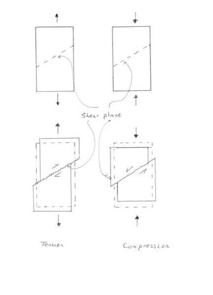

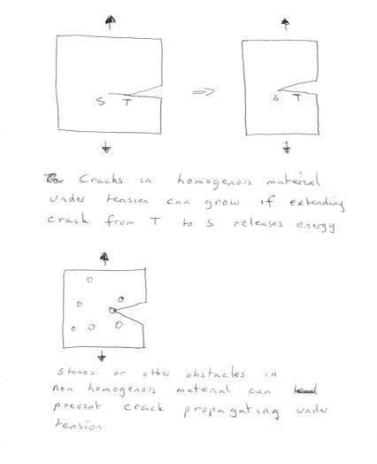

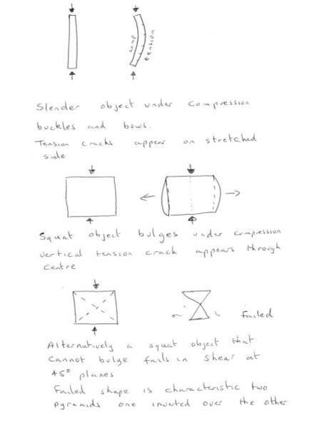

I have uploaded a couple of sketches about the way cuttin g tools work.
Since we have been talking tension/compression/shear I am assuming you know what these are, although you said you are not a physicist. If you have any doubts or queries, please ask for clarification.

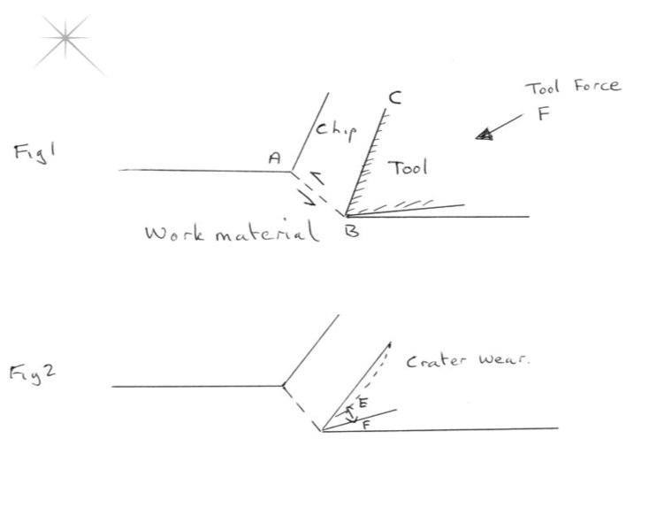

Fig 1
Shows a cutting tool being forced along the surface of a workpiece.
The force from right to left causes a shear stress to develop across the neck of the top layer of the workpiece at AB.
This in turn causes a chip to shear off along BC, the upper face of the cutting tool.
This is also why it is easier to start with a shoulder or edge when cutting.
Notice that in Fig 1 the width across the tool to shear is much greater than the AB so the workpiece will shear in preference to tool. Also the tool shear resistance should be greater than that of the work (but not always).
Now you were asking about tool failure so here goes in Fig2
The contact face BC between the tool and the work is subject to large forces and tends to heat up as a result of the energy transferred.
This has two effects.
Firstly as shown this face is subject to wear, what is known as crater wear, as shown dashed in the diagraram.
Secondly the local heating can locally soften the tool material ( and the work material but we are not considering this).
The first reduces the section to the tool available to resist the shear at EF
The second reduces its shear strength.
At some point a crack will initiate across EF.
Repeated blows will casue this to propagate in the weakened tool material.

Ok, I think your picture illustrates a misunderstanding. Sorry, can't send you a picture at the moment, but perhaps your picture makes it unnecessary.
The picture is typical of a machine cutting tool, in that the back side of the tool is NOT under pressure from the material being cut, but the front is. Note, the back doesn't even touch the workpiece!
But the punch is not truly a cutting tool. It is a splitting tool, and works like a wedge for splitting logs. pressure from the two sides, not from the cutting tip, separate the stone.
The fact that the tip cuts into the stone is actually irrelevant because the punch would still work the same way even if you drove into a pre-drilled pilot hole. In such a case, the tip would never touch stone, but the result would be the same. (A wedge driven into a pre-drilled hole is in fact one of the main ways to divide stone.)
The problem with understanding the punch is that BOTH sides are under equal pressure until the instant of chip release. Until it breaks, there should be no shearing force across the tool other than from random irregularities in stone, etc.
The real question is, does a shearing force appear at the instant the chip is released, because the pressure from the chip side vanishes almost instantaneously, when the chip suddenly releases. This would be similar to the picture, but backwards, because the greater pressure would be from the back, not from the chip side!
No I don't think it so.
I understand the splitting action you are talking about, but I think it is more complicated than you have described.
Yes I agree the diagram is a modified version of a metal working tool (could still be handraulic - doesn't have to be machine cutting). I did mention that cutting is easier against a shoulder - we call it scutching in brickwork.
When you apply a cold chisel to a surface that has no shoulder and try to drive it in, there is obviously initially no side pressure on either side, until it is partly embedded.
The actual embedding process must cause a slight local rise in the work material surface, there is nowhere else for it to go.
Once the crack has initiated (slitting action) it can propagate through the material with the grain. This is what happens in timber and stone with a definite grain such as slate, or it can be stopped by inhomgeneity (non isotropy) in the material. Wedges don't work well across the grain.
What I think happns is that the the tool encounters a harder bit and gets deflected one way or the orther, or worse still get twisted slightly.
Either of these combined with the shear, inherent in the axial force applied, are known to be the worst case loading for any component. Acceptable axial loading plus unintended torsion has broken many a component prematurely.

In attachment 1 I have shown specimens of material with subject to tensile and compressive loads.
If we take any plane at some random angle to the axis of the force, as shown dashed, this plane acts like half a wedge (=inclined plane).
If the two parts of the specimen, as separated by this plane, were physically separate the applied forces would either drage the upper section up the plane (tension) or push it down (compression0 as shown.
This implies a force acting parallel to the plane.
And indeed there is - it is the shear force.
The effect of the inclination of the plane is to tilt or rotate the effect of the applied force.
Now obviously unless the material actually breaks this remains a (shear) stress within the material, rather than a displacement.
The actual value of this shear stress obviously depends upon the actual value of the applied force. It also depends upon the angle the plane makes with the axis.
It is easier (requires less energy) to make the material slip sideways as shown than to pull the material physically apart, which is why the shear strength is (much) smaller than the direct stength of materials.
Since you want to concentrate on tool failure we should look at the compression loads next.
The response of an object to compression is considerably more influenced by its geometry that for tension.
So, as shown much exaggerated in attachemnt 2, a slender object, such as your chisel, bows or buckles slightly when struck.
Remember that impact forces are much greater than their static equivalents.
Tension appears along the stretched side of the now curved implement and, especially if the tool is not rotated (remember I mentioned this) microcracks will appear and start to grow (as in attachment 3), since chisels etc are made of brittle materials.
A more squat object under compression bulges out sideways, if allowed to, and eventually fails by what is known as central or diametral splitting. Again the action within the material translates the compression into internal tension.
If for some reason, for instance because there is more material to each side of our specimen confining it, shear stresses are also developed as shown in attachement 1. The maximum shear occurs at 45 degrees to the applied compressive force, and the material eventually fails in shear along these lines.
The last part of attachment 2 shows what happens to a cube of concrete when tested to destruction by crushing. The double pyramid result is quite characteristic.
This is what happens to the rock directly inder the punch or chisel point.
Both the stone and punch are brittle materials and attachment 3 shows what happens to a crack in such material when tension is applied across it.
In homogenous material, (metals or the matrix in concrete and marble) the end of the crack is at point T.
If the energy gained from the work done by the applied tension is greater than the energy required to tear the material between T and S asunder, the crack will propagate (open) from T towards S and eventually through the whole material.
This is quite a sudden process, that gives little or no prior warning before it happens, and is sometimes termed 'fast fracture'
It is also what happens to your tool tips.
On the other hand the last part of attachment 3 shows what can happen in a non homogeneous material.
Embedded obstacles, such as small stones, prevent the crack propagating directly. Directly means at right angles to the tension. At any other angle the tension has less effect, so less energy is availble to divert the crack off course. Obviously if the tension is great enough this is exactly what will happen.
