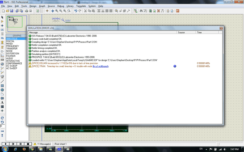

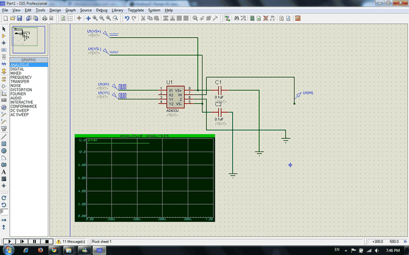

Hi,
Currently i am using Proteus 7.4SP3 to simulate the AD633 multiplier. The two input is a trend of pulses and i want to get the output. The problem is that it occur 2 warnings which is then stopped my simulation.
1. [SPICE] DELMIN increased to 1.11022e-016 due to lack of time precision
2. [SPICE] TRAN: Timestep too small; timestep = 0: trouble with node #v:u1:nc#branch
I had attached the jpg for you to refer. Please help and commend about the problem. I need your help very much. Thanks =)
The four X and Y inputs are op-amp inputs, the unused X2, Y2 inputs must be connected to an appropriate voltage, probably Ground in your circuit.
