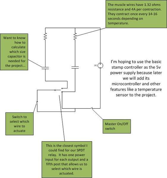

I attached our plan. Thank you very much for all your help :)

However, I'm not sure what is happening with your circuit.
(There seemed to be an extra wire from the bottom switch position to the negative line.)
But it looked like the capacitors would charge up and have no way of discharging. Maybe it is the way you have drawn the switch contacts. Is the electrical path as you have shown?
Do these muscle wires contract by themselves, or do they do it because you apply power at regular intervals? The only reference to Flexinal on Google was your post about it here.
I appreciate your time here, thank you for the formula. I haven't come across that one yet. I'm using "Foundations of Electronic Circuits and Devices" 4th edition which probably has all of this information but I don't always know what I'm looking for. I'll investigate what you've given me. Much appreciated :)
As far as the wiring is concerned the actual SPDT relay I have has two power input posts and two power output posts with a fifth post that actuates which power line is getting connected. This is because it can handle a much higher voltage than what is necessary to actuate it (so that later I can actuate with a pulse from the basic stamp microcontroller). Is this what you mean by an extra wire?
For the capacitors, I couldn't see which side was curved when I was drawing them so they may be backwards. The idea is that they are charged when the SPDT relay is on their path and once charged up, they hit the muscle wire with a pulse, causing it to contract.

That circuit would give you one pulse when the capacitor charges, but there is no way of discharging the capacitor. So, it would only work once.
If you could make a different choice of wire, there would be advantages. For example, if you chose the 0.006 inch wire, it would have a resistance of 16.8 ohms per 12 inches.
You could switch power to this using your Basic Stamp to provide exact timing.
It would require a simple 2 transistor amplifier to do this and you would need one for each wire.
The current would only be 300 mA from a 5 volt supply. This can be increased by increasing the supply on the right in the diagram below. The specifications suggest a current of 410 mA, so you would need about an 8 volt supply to get this current.
[PLAIN]http://dl.dropbox.com/u/4222062/Darlington.PNG
This is an example of the sort of circuit you would need. The transistor types are fairly optional, although Q2 needs to be a power NPN transistor.
At the left is a circle which would represent the Basic Stamp. (If you are not committed to this, the Picaxe series of chips are much cheaper and use a similar language).
It would produce a single pulse of 1 second duration and this would apply a current to the wire. When the pulse goes away, the current stops.
I have shown the effect of varying the voltage from the Stamp, but you would simply supply a 5 volt pulse to one of the outputs of the Stamp. Only 1.2 mA would be drawn from the Stamp.
You can vary the pulse width with the programming of the Stamp chip.
You would need to take another pulse from a different output to a similar amplifier for another wire.
The 16.8 ohm resistor is your wire.
