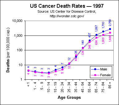

Again, cancer is a disease of age--An accumulation of gene maladies because the process of replicating biological information is not and cannot be perfect (of course, as I pointed out above, there are exceptions to the "rule")
Anyway, for an fyi type of thing;
As the man says "disease of age"
Interestingly we can look at the rate of cancer over a span of time;

And at first glance would appear to support the "cancer on the rise", but nicely overlaid by a change in life expectancy over a similar period of time;
[PLAIN]http://divisionoflabour.com/archives/life%20expectancy.JPG
the point was that life expectancy has increased in the modern world and this will inevitably increase the "frequency" we see and treat cancers.

bobze & hamster, it would also seem logical that the apparent increase in the diagnosis of cancer would be due to our increased ability to diagnose it, no?
Bingo. Many cancers prior to our modern era simply went undiagnosed. In fact, prior to our modern era, many people never saw a doctor or dentist.
I saw a few life expectancy charts earlier, which are very misleading when talking about cancer, as cancer is but one of many causes of death, and many of those causes have dramatically shifted over the last 100 years, including infant mortality rates, poverty levels, malnutrition, as well as causes of death profiles in various age groups. It's not that we were incapable of living past 50 years of age in 1900. Wyatt Earp died shortly before his 81st birthday, in 1929, and Mark Twain passed away in 1910 at the ripe old age of 75.
Twain, however, outlived three of his four children.
