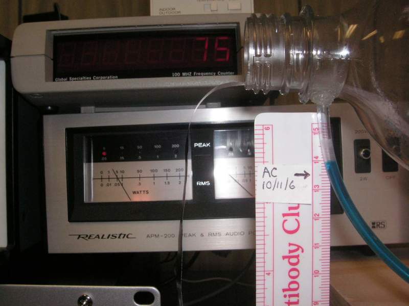

For low frequency, AC airflow, I used a Polk Audio, 50 watt woofer driven by a sine wave generator and audio amplifier. I also connected a frequency counter (since the wave generator, made from a kit, is only approximate) and an audio power meter. At 75Hz, I show a lift sequence increasing from 0 to 15 watts RMS (see photos). If you want to try this and don’t have a good woofer handy, take a walk around your neighborhood on trash night. Many folks upgrade their TV/computers and toss out old subwoofers. Decent function generators are available for around $40 from Elenco (Amazon has them). Audio system amplifiers and many home theater systems have an Aux. input which can be used for amplification (but don’t use the family’s main unit, in case you burn it out.)

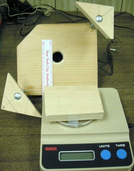

The same effect can be accomplished dramatically with orthosonic lift involving radial deflection. I mounted a woofer to a wood faceplate with a 1 inch central hole, nicely beveled around the inside and outside edges. This was mounted face down 4.5mm above a solid board taped to a lab scale. At 55Hz, I gradually applied power (RMS) to the woofer. Lift was measured as decreasing grams from the board on the scale. Here’s what I got.
watts : grams lifted
0.0 : 0.0
0.5 : 1.5
1.0 : 3.6
2.0 : 11.2
2.5 : 17.5
5.0 : 28.6
10.0 : 51.3
20.0 : 64.2
30.0 : 73.0
40.0 : 80.4
Above 40 watts the 75g board and metal scale pan were sucked right up off the scale base! With a narrower gap between the speaker faceplate and the lower board, the effect was markedly increased. For example at 55Hz and only 5 watts, a 2.1mm gap lifted 52.2 grams, almost twice that achieved at 4.5mm!

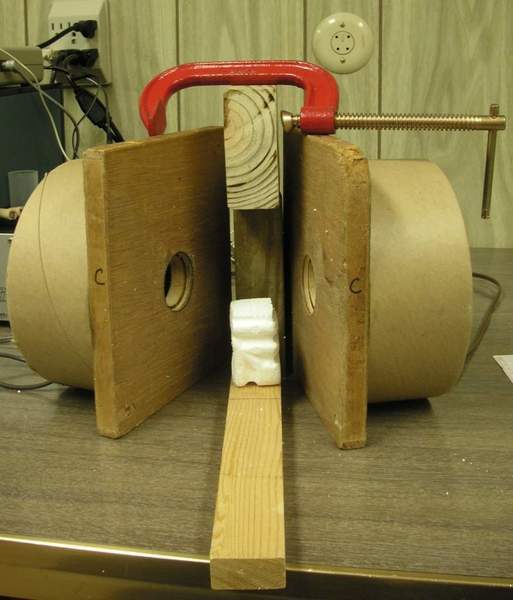

To lift a non-airfoil, I cut a 2 x 2 x 1.25 inch (1.8 gram) Styrofoam brick. This was slid between two woofer faceplates (1.5 inch apart) with the floor, roof and back wall blocked off. The woofers were wired antiparallel to have their facing cones move left and right in unison.
At 40-45Hz and 2-4watts RMS/channel the Styrofoam lifted well between the open ports. (4watts for lift off, 1watt to cruise). Both lift across the flat top and bilateral radial deflection may have contributed to the rise but either way, this "flying brick" is courtesy of orthosonic lift. In addition, if a torn out magazine page is held in front of the opening between faceplates, it is readily sucked in when power is on.

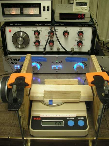

I wanted to quantify flat wing, zero angle of attack orthosonic lift. The woofer faceplates with circular ports were replaced with faceplates having horizontal oval ports. Between these, on the scale, a small wooden sled was placed. The sled consisted of a 8.0 x 2.25 x 0.75 inch plank with thin (popsicle stick) sidewalls attached to contain sonic flow from the oval ports along its length. The sled had a mass of 109.7 grams when taped to the scale pan. With sonic flow above the plank (65Hz, RMS watts/channel), orthosonic lift was apparent as a reduction in apparent mass as shown.
watts : grams lost (upward orthosonic lift)
0.0 : 0.0
1.0 : 1.1
5.0 : 5.4
10.0 : 7.3

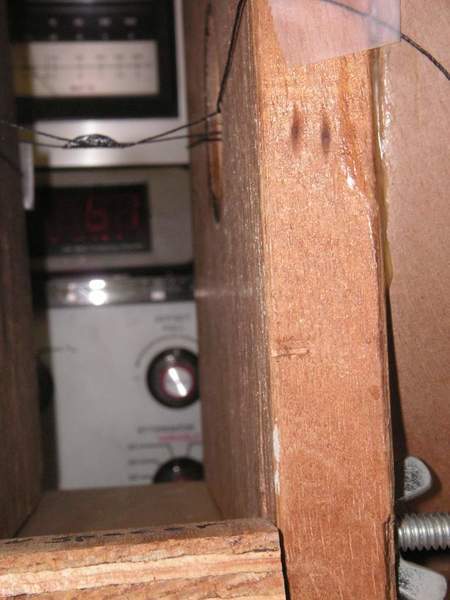

Anyway, I’ll jump to a snag with orthosonic lift. When I used a lightweight speaker and a small sled, I verified orthosonic lift produced by flow over the plank, so Bernoulli looks good with Vrms. But when I move the speaker on the scale with the sled, Newton's ghostly finger presses down on it and exactly cancels the lift. (Both shown at 45Hz, 2 watts RMS)
Similarly, if I place just a speaker with a ported faceplate on the scale there is no change in apparent mass with sonic flow (110Hz, 1.5 watts RMS). But when I raise and lower a horizontal flat wing in front of the port, the speaker registers the exact opposite of lift experienced by the wing. It would seem that orthosonic lift does not wish to bootstrap its engines. Yet conventional engines and wings using DC flow bootstrap themselves off runways everyday! Now I’m the one missing something.

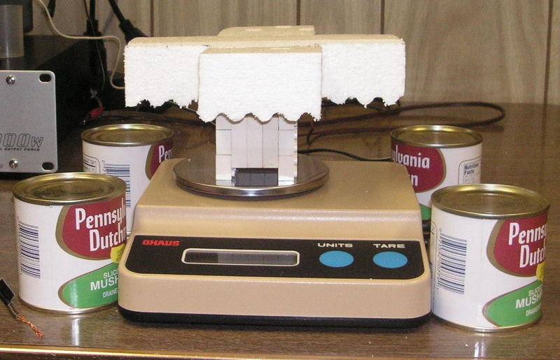

Before I start a new thread in the Aerospace forums for high frequency orthosonic lift, I thought I would make note of one more aspect of my low frequency work. Remember your introduction to oscilloscopes when they got you to combine sine wave signals on vertical and horizontal axes? The resulting ovoid Lissajous patterns should be physically realized by crossing sonic flows.
Since orthosonic lift seemingly depends upon RMS particle velocities, there are important limitations associated with higher amplitudes. We can only practically push the compressions and rarefactions so far. Energy requirements rapidly climb while increases in particle displacements diminish. I believe this can be alleviated by crossing two sonic flows at right angles and proper phase, with the compression of one flow corresponding to rarefaction in the other. The result, in my view, is vortigenic flow or mini-tornados, complete with attendant roof-pulling suction (lift).
My 13.3 gram, flat-topped, Styrofoam x-wing showed a 2 gram decrease in apparent mass at 70Hz, 2 watts RMS into each pair (4 ohms) of opposing woofers. At 10 watts/pair the wing hovered above the scale mount. When I tried to visualize the vortices with confetti and cork dust, the materials were quickly swallowed into the woofer ports, not to be seen again!
