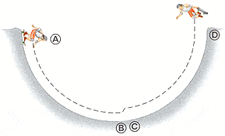

A skateboarder with his board can be modeled as a particle of mass 79 kg, located at his center of mass (which we will study in a later chapter). As shown in the figure below, the skateboarder starts from rest in a crouching position at one lip of a half-pipe (point circle a). The half-pipe is one half of a cylinder of radius 6.90 m with its axis horizontal. On his descent, the skateboarder moves without friction so that his center of mass moves through one quarter of a circle of radius 6.40 m.
(b) Immediately after passing point circle b, he stands up and raises his arms, lifting his center of mass from 0.500 m to 0.870 m above the concrete (point circle c). Next, the skateboarder glides upward with his center of mass moving in a quarter circle of radius 6.03 m. His body is horizontal when he passes point circle d, the far lip of the half-pipe. As he passes through point circle d, the speed of the skateboarder is 4.66 m/s. How much chemical potential energy in the body of the skateboarder was converted to mechanical energy in the skateboarder-Earth system when he stood up at point circle b?
Conservation of Energy
The actual answer is 571J
[tex]\Delta[/tex]KE + [tex]\Delta[/tex]PE + [tex]\Delta[/tex]CE = 0
m[v2/2 + g[tex]\Delta[/tex]h] = [tex]\Delta[/tex]CE
79(11.22/2 + 9.8(0.5 - 6.4)] = -[tex]\Delta[/tex]CE
And it isn't 571J...

hi flyingpig! :smile:
(have a delta: ∆ :wink:)
you've used KE instead of ∆KE :redface:
find ∆KE by finding the new v by using conservation of angular momentum (and why does that work? :wink:)
"Chemical Potential Energy" is is all the energy used up, including that wasted on producing heat and sound
but it doesn't matter … all they're asking is what is the difference in mechanical energy :smile:

But our class haven't learned angular momentum yet...we are suppose to tackle this problem with only energy and I used ∆KE, energy initially was 0
hmm … imagine his arms were really long, and he was holding onto the centre of the circle …
when he reaches the bottom, he pulls his arms in, to pull himself up, and his angular speed will increase in exactly the same way as when a spinning skater pulls his arms in (kinetic energy is lost because the skater has to do work to pull his arms in) …
this is conservation of angular momentum …
i don't think you can do the problem without it :confused:
EDIT: actually, you could do it by calculating the work done by the reaction force instead, but that would involve an integration, and you'd need to know the centripetal acceleration formula, v2/r​

Could it be that by raising himself up, he's given himself some potential energy? Had he never raised himself up, he'd only have the potential energy due to his starting position as the initial energy and his energy at the lowest point would be that of just a particle with that specific potential energy. But, by raising himself up, his chemical energy (due to muscles etc) has added an increase in potential energy, thus having more energy at the lowest point than just a particle would have done.

Oh okay, I think I sort of get it now
V(0) = 11.2m/s
R = 6.4m
V(?) = ?
R = 6.03m
(11.2)(6.4) = x(6.03)
v(?) = 11.88m/s
∆mgh + ∆m/2 (11.88^2 - 11.2^2) = -∆CE
-57.82 + 619.9288 = 562.1088J
Really close now...

Yes, this looks ok :smile:, except I don't see how you got the 57.82.

∆mg(0.5 - 6.4) + ∆m/2 (11.88^2 - 11.2^2) = -∆CE
= 3950J...
I am lost again...please help. it's due tomorrow!
flyingpig said:
∆mg(0.5 - 6.4) …
oh i see …
no, i think the 0.5 is already subtracted: 6.4 = 6.9 - 0.5
hmm … I've looked at the question again, to see what the second part was, the one with D, and on second reading it looks as if the given speed at D is actually an integral part of finding the chemical energy at the bottom …
it's a weirdly long question, and perhaps you're meant to ignore almost everything in it, and just subtract the KE at A (which is zero anyway) from the KE at D (since the PE at A and D are the same) :confused:

I have 4.66^2 * 0.5 * 79 = 857J...
Quick, back-of-an-envelope kind of thing (I'm taking my zero of energy at the bottom of the original path):
Energy at A = 79*9.81*6.4 = 4954.88
Energy at B = m*(v_b)^2/2 = 4954.88 -> (v_b)^2 = 125.44
Energy at C = m*(v_b)^2 + mg(0.37) = 5246.68
Energy at D = m*(v_d)^2 + mg(6.4) = 5817.69
Energy(D) - Energy(C) = 571
(I'm taking my zero of energy as the bottom of the original path)
Sorry, I forgot to write down the factor of 1/2 for E(C) and E(D). It's just a typo. The calculation includes the 1/2.
