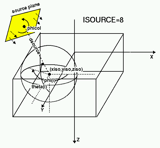

I'm using some software where the location of a plane with respect to a point is defined using spherical coordinates. I've attached a visual guide of the software parameters to this post, if someone is interested.
I'm not having problems defining the position of the plane with respect to a given origin [there are no problems calculating the polar angle theta using acos(k), the azimuthal angle phi using atan2(i, -j)* and the distance r], but I am having problems determining the rotation in the plane tangential to the sphere (positions in this plane a defined using x,y coordinates, with 0,0 being the point defined by the spherical coordinates).
Different theta/phi combinations effect a rotation in this plane. I understand why this is the case: a combination of pitch and yaw results in roll. I can observe the effect, for instance, when I open up Google Earth and rotate to a different latitude and longitude - I see that the camera rotates (the north and south directions change).
* this -j is required for the software to provide the correct answer; I believe it indicates that the plane is facing the origin of the spherical coordinate system
I'm a stuck on how to quantify this rotation. Is there a simple way to calculate the rotation in this tangential plane between two sets of i,j,k (or r, theta, phi) values?

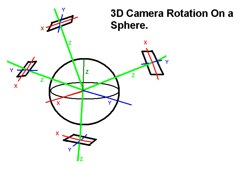

In this software, the 'default' parameters are polar angle θ = 90, azimuthal angle Φ = -90 and the plane rotation φ = -90. This results in a plane with an origin on the y-axis, facing the positive y-direction. The output of the software with these parameters is as expected. A φ = -90 produces expected output whenever θ = 90. But with different combinations of θ and Φ, it seems there is an effected rotation of the plane, that I need to quantify, in order to remove it.

I believe what is happening is the same thing that occurs when a camera rotates about a sphere, as in the picture I've attached. There are varying rotations in the orientation of the plane at different points about the sphere. This makes sense when considering the constant φ when θ=90: the x and y projections in the plane do not change as you rotate about along the meridian.
I first thought that if I gathered enough sets of working angles, I'd be able to see the relationship between φ and (θ,Φ); but it isn't apparent. I've read about rotation matrices, euler angles and quaternions, but I don't know how to apply them to get the relationship I'm after (or if they are even appropriate).
