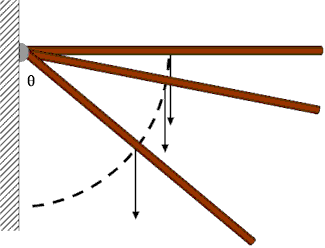

I got a question regarding conservation of mechanical energy. The mechanical energy of a system is conserved, as long as there are no transfer of energy (like heat, work, mechanical waves etc.), right? So, why is the mechanical energy in the system of the pivoting rod and the earth, as shown in the picture below conserved? Isn't there are a force acting from the pivot point, doing work?

Work is force integrated over displacement. No displacement, no work.
However, if you go into moving coordinate system, where pivot is moving relative to observer, the pivot does do work. In that coordinate system, however, the total energy of the rod does change.
Momentum is more interesting, since momentum is force integrated over "displacement" in time. That means that momentum is transferred from rod to the pivot in any coordinate system.
Start by considering what happens if the rod is not connected to the Earth at a pivot point.
The system of the Earth and the rod has gravitational potential energy when the two objects are separated in space and they have the er.. "potential" to fall towards each other.
When such a rod does fall freely downwards the Earth also falls upwards towards the rod. The system overall loses potential energy and gains an equal quantity of kinetic energy. Total energy is conserved. Virtually 100% of the kinetic energy goes into the rod.
Now attach the rod to the pivot as shown in diagram message #1. The upright section supporting the pivot must be in contact with the earth, not shown in the diagram but assumed.
This is a more complex situation. The free end of the rod is similar to the entirely free unconnected rod as described above. But the pivot end of the rod is similar to an object resting on a fixed platform - where gravitiational potential energy remains constant because nothing moves. The overall system is therefore a mixture of those two conditions.
Conclusion:
When released, the rod and Earth system do experience a partial movement towards each other but the movement is somewhat limited by the support at the pivot end of the rod. Despite that limited movement however, there is nothing really strange happening. The rod is falling a small distance towards the Earth whilst gaining kinetic energy. Also the Earth "falls" an unmeasurably small distance upwards (lifting the pivot).
And... in the pivot case, the Earth must experience a sideways force while the rod is swinging downwards, transmitted as a tension force through the pivot. So angular momentum is also conserved. When the rod is swinging through its lowest position the Earth's rotation is changed by an unmeasurably small angular speed in the opposite direction. That's nice!
You don't need to make it that complex. You can assume that the support is infinitely massive and does not move in response to rod's movement. There is still nothing weird happening with the energy.
