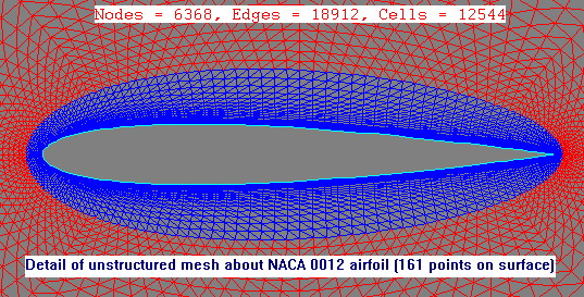

A symmetric air foil would be a good example of one that can fly upside down or right side up without a degradation of it's properties. For non-symmetric air foil, all it takes is a small adjustment of the ailerons to give it lift in the upside down direction.

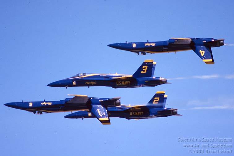

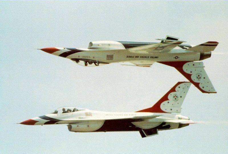

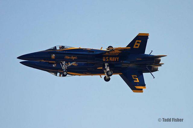

Here's a good example of the same airfoil being utilized right-side up and upside-down at the same time. Looks to me like airfoil's generating lift in both directions (small aileron and AoA changes), so the OP question has been answered. Thrust is definitely not the only thing keeping these planes in the air.

This pic is actually pretty much impossible to refute. Because we can see both craft, we know the inverted one is indeed in virtually level flight, and its thrust is also virtually level. No amount of overpowering from that engine could possibly keep that jet flying parallel with the lower jet.
The craft must be getting lift via its wings.
