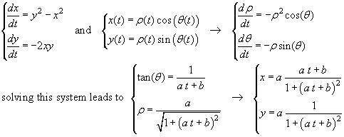

Solving in polar coordinates is easier. The main steps only are shown in the attached document.
perfect! I got it! Thank you very much :D

But I like the polar coordinates method better.

OK. far to be easier, but possible, even without knowing the solution.
Remark : the obvious particular solution [ x=1/(t+c) ; y=0 ] is included in the set of solutions in the particular case of b=c*a and a=> infinity.
