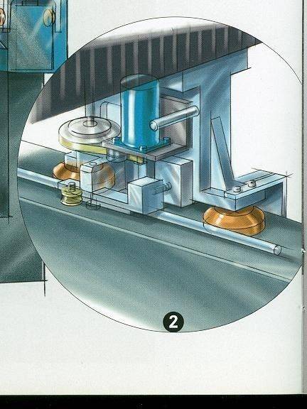

this is a zero backlash friction drive used on a machine i sell. note groved drive pulley and tension pulley opposite,
