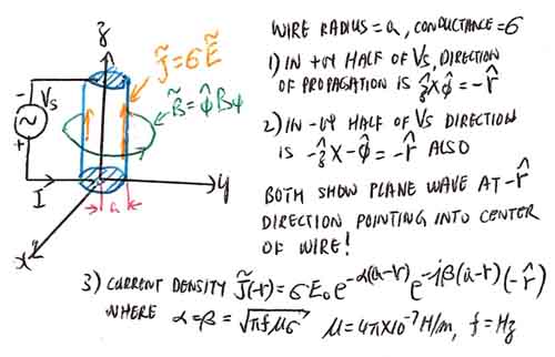

I want to verify my understanding about skin effect and plane wave of conductor wire.
In the diagram, assume long straight on z axis. Wire with radius = a and conductance = [itex]\sigma[/itex]. Accouding to the equation shown, the plane wave is going towards the center of the wire only regardless of the instantaneous polarity of the Vs. My questions are:
1) Is this how to look at the skin depth? By putting a voltage across the wire that generate the current density [itex]\tilde J = \sigma \tilde E[/itex] in say +ve z direction according to the drawing. As noted, [itex]\tilde B = \hat \phi B_{\phi}[/itex]. The direction of propagation is [itex]\hat z X \hat {\phi} = -\hat r[/itex]. Are my drawing and description correct?
2) You can see in both polarity of Vs, the propagation is towards the center of the wire. But we know there is a plane wave propagate out of the wire into the space and is perpendicular to the wire in [itex]\hat r[/itex] direction. How come I don't see it in the equation?
3) This is the most confusing question. Why is the E field started at the surface and propagate into the wire. When you apply voltage across the wire, the E at the center of the wire should be the same as right underneath the surface of the wire. You can look at it as the E start at the center and decay when traveling outward since the voltage across the wire is same at the center of the wire as right below the surface.
In another words, why we start considering the E on the surface only and calculate the plane wave instead of starting at the center of the wire and calculate outwards. What make the E on the surface only? From the book, it is almost like they start the E right above the surface of the wire in the space, and then use boundary condition that tangential E = [itex]\hat z E_0[/itex] is continuous cross the boundary so the E right below the surface of the wire is the same E = [itex]\hat z E_0[/itex]!

It sure seems that if a plane wave with E in z direction and H in [itex]\phi[/itex] direction, current will also be generated as show in the diagram.
BUT all the books talking about AC current travels on the surface of the wire and the plane wave pointing into the center of the wire. In order to create current through the wire, a voltage source is needed like in my drawing. So this is definitely not talking about an external plane wave hitting the wire ( surface of the conductor ).
This is the exact point I want to verify in my post also. I think this is confussing.

By "set up the skin effect", I meant the external Vs across the wire generate the E field from J=[itex]\sigma[/itex] E . According to my diagram, E is in z direction and B in [itex]\phi[/itex] direction. The plane wave generated by the E propagates in [itex]\hat z X \phi = -\hat r[/itex] direction. The attenuation is what we call the skin effect.
Okay, I think I'm following you now. Your question is why the E-field is seen as beginning at the wire surface and propagating inwards, rather than beginning at the center and propagating outwards?
As far as I can see your sketch seems correct. A current flowing in the [tex]\widehat{z}[/tex]-direction seems to imply an em wave propagating inwards, towards the center of the wire. Is this not in accordance with what is written in literature?

This is the latest part of my question. Like you said, E is not necessary zero in AC condition. So it is just a plausable for E to start in the middle of the wire as on the surface.
Yes, that seems to be what the books said. The only difference is none of the books mentioned where the origin of the plane wave is. They all just said the plane wave on the surface suffer attenuation as it penetrate the surface into the conductor. That does not say anything about the where the plane wave come from. It can well be an external plane wave perpendicular to the surface hitting the surface of the conductor. IF that is the case, then that has nothing to do with skin effect of the AC current conducting through the wire.
The fact that skin effect happen when an AC current pass through the wire indicate my drawing has to be the interpretation of where the plane wave come from.
