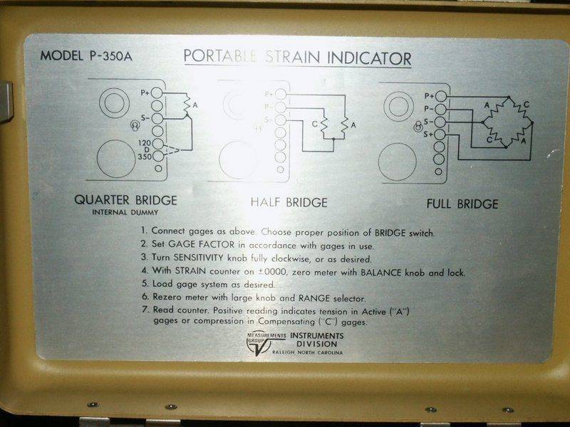

The original Wheatstone bridge was invented in the 19th century, before the era of electronics. Apart from as a teaching tool (i.e. they are a circuit that you can analyse and experiment with) electronic measuring instruments have made them completely obsolete.
Simple methods are not obsolete, and are still used effectively in harsh environments that might upset delicate electronics, especially for slowly changing measurements such as the opening of a crack in a rock face or a building.
Here are some pics of a portable device.
