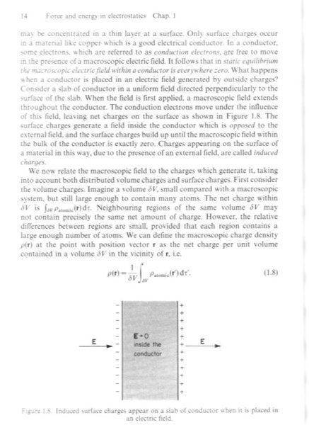

An electric field cannot exist inside a conductor, so the introduction of a conductor 'shorts' the points A and B to the same potential. An electric field can only exist in a dielectric medium.
No, a field can exist inside a conductor … it takes time to short A and B to the same potential, and the field exists until the current has had time to build up an emf opposing it … from Scott Hughes' 2005 MIT lecture http://web.mit.edu/sahughes/www/8.022/lec05.pdf" …
There is no electric field inside a conductor. Why? Suppose we bring a plus charge near a conductor. For a very short moment, there will be an electric field inside the conductor. However, this field will act on and move the electrons, which are free to move about. The electrons will move close to the plus charge, leaving net positive charge behind. The conductor’s charges will continue to move until the “external” E-field is canceled out — at that point there is no longer an E-field to move them, so they stay still.
A more accurate statement of this rule is “After a very short time, there is no electric field inside a conductor”. How short a time is it? Recall that in cgs units, resistivity (which tells us how good/bad something conducts electricity) is measured in seconds. It turns out that the time it takes for the charges to rearrange themselves to cancel out the external E-field is just about equal to this resistivity. For metals, this is a time that is something like 10−16 − 10−17 seconds. This is so short that we can hardly complain that the original statement isn’t precise enough!​

Further, because the electric field inside a conductor is zero, no work is required to move a charge between two points inside the conductor. ...books.google.co.uk/books?isbn=0495386936...
My underlining
http://books.google.co.uk/books?id=...a conductor in an electrostatic field&f=false

So a resistor near a charge do not show any change… but if we move it back or forth or turn charge on and off, it will show some instantaneous current and voltage??
And studiot, a capacitor with dielectric and a conductor are not same.
Dielectric is a material with polar molecules which just align when electric field is applied. They don’t conduct like conductors as there are no free electrons, just polar molecules.
And wiki defines EMF as work “per unit charge” not work. Check V and W/q dimensionally … they match!And please tell me one thing … ““ Iin case of battery, EMF is the charging force or not? ””
