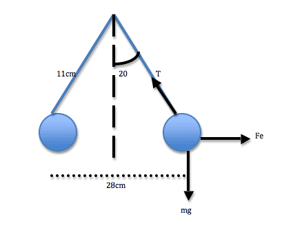

Suppose that two balls of mass 1.5x10-4kg each carry equal charges and are suspended by identical threads of length 11cm anchored 28cm apart. If each thread makes an angle of 20 degrees with the vertical, what is the charge on each ball?
F=kq2/r2
From a free body diagram of one of the masses:
mg=Tcos20
Fe=Tsin20
which can be combined to Fe = mgtan20
using the above equation:
q=(mgtan20/k)1/2(0.28m)
using this, I get 6.8x10-8C
can some one point out where I'm going wrong?
It is always useful to read the problem carefully and sketch the set-up. Are you sure that those balls are 28 cm apart? What does "anchored" mean? And what are anchored 28 cm apart?
ehild
The attached thumbnail would be my interpretation of the problem, where the masses are "anchored" by repulsion, giving the distance between them to be 28cm. Therefore, by saying anchored, we know that the net force is 0. Am I approaching this the wrong way?

English is not my first language, but the dictionary says "Anchor: Fix firmly". The balls are not fixed at definite places, but kept there by the balance of forces.
"two balls of mass 1.5x10-4kg each carry equal charges and are suspended by identical threads of length 11cm anchored 28cm apart"
Does anchor refer to the masses or to the threads?
Anyway, try the other set-up and see if you get the demanded result.
ehild
That would be the problem, thank you.
I forgot to point out that the distance between the masses in your figure can not be 28 cm. (It is 2*11*sin(20°)= 7.5 cm. :)).
ehild
that distance 28 cm is actually b/w the pt. of suspension of the 2 threads...
