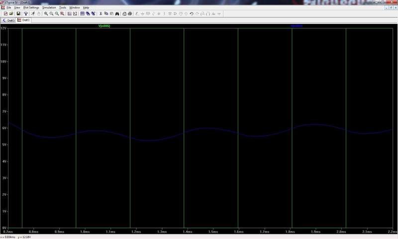

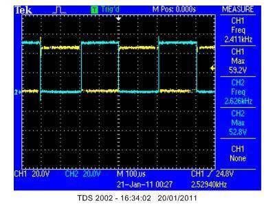

Oh wow thanks, I used a 555 timer to generate a pulse 2kHz but i am having problems getting the negative cycle of the squarewave. i tried inverting(not gate) the signal and putting into a H-bridge chip(L293), still no negative cycle. i got two pulses that are out of phase O_o. I designed and simulated a active filter which works perfectly using a 741 op-amp. I will looking into the microcontroller option thanks a lot ^_^
you don't really need a negative pulse to form the negative part of your AC output, what u should do is to get flip-flop chip (D-type) feed your control signal through the flip flop data input and take your complementary outputs from the the Q and ~Q pins. However, doing this will cut your output frequency in half, so you have to go back to the timing circuit, and increase the frequency(i.e if your ac frequency is f then the signal frequency input to the flip flop will be 2f i.e timing frequency of your 555 timer should be 2f) Note: I suggest that you try using sg3524, it has complementary outputs and the control circuitry is simplify. Refer to the datasheet to see details. see the attached file
Also, note that to have pure sine wave ac output, you need to use High frequency ferrite transformer because at high frequency iron core transformer will saturate easily and overheat causing damages to your circuit.
