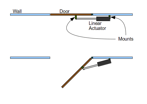

would a electro-mechanical actuator connected to a power screw be able to open the door? An arm attached from the shaft to the door could rotate the door and the power screw would allow it to stop. Not sure yet how I will connect the motor to the power screw yet, possibly gears?
Steve,
I don't completely understand your concept. What I had envisioned looks like the attached image. The linear actuator will keep pulling/pushing for as long as a current is applied. The direction of the actuator (push/pull) is changed by swapping the voltage polarity which is usually done with a double pole double throw switch.
Once you know the weight of the door, you can select a linear actuator based on load capacity and stroke length to match to your mounting point and the weight of the door (lever arm, moment).
yes that looks like a very good idea alright. A huge force will be required from that linear actuator to open the door but I think it could work. It is also very simple. Is the linear actuator mounted on some sort of pivoting system so that it can open the door to angles of 90 degrees and over? Also Any ideas for the inclusion of a locking system for this design?
My previous idea included a large shaft going parallel alongside the door, connected to an arm which had one end welded to the door and the other to the shaft. A rotary actuator would turn this shaft, thus turning the arm and opening the door. To close the door, this process would simply be reversed. This idea seems more simple though.
In the concept I described, the actuator would need to be mounted with brackets like those used for screen door closers.

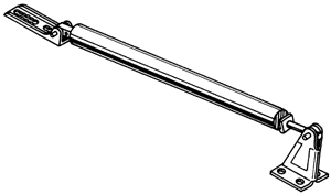

A good place to look for available push/pull forces and stroke lengths is http://www.firgelliauto.com/" . I've worked with them in the past and found them to be very helpful.
Something that might work for you is the 450 lbf, 30" stroke length actuator. They even sell matching brackets that allow for pivoting.
Unfortunately, you have a lot of things to still consider. The minimum force of the actuator is determined by the point on the door where it will be attached (Force x Distance = Torque). The torque must overcome the moment created by the weight of the door revolving about the hinges. The retracted length of the actuator and the mounting point on the wall are affected by both the torque and the distance the door must open.
