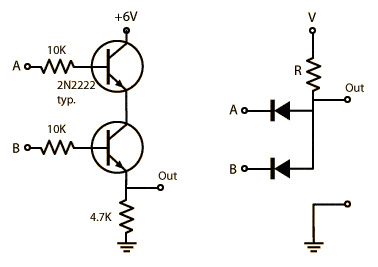

hi guys,
ok I thought I understood this till I looked further into that link and saw this diag
showing the transistor and the diode version side by side.
what puzzles me now is, in a floating input state, the transistor version the output is pulled low via the 4k7 resistor but the diode version is pulled hi by the resistor to +V so they are opposite.
That is correct isn't it ?
Inferring that one would have to take that into consideration if making discrete component gates?

davenn said:
hi guys,
Dave
There are both pull-up and pull-down resistors in logic gates, but the logic is the same. The only difference in the states are the voltage ranges for the high and low states.
