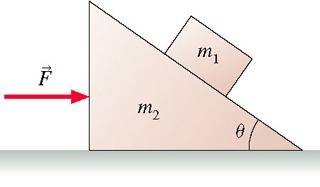

Find an expression for the magnitude of the horizontal force in the figure for which does not slip either up or down along the wedge. All surfaces are frictionless.
I am a little confused, what is this question really asking? i have attempted sevral trig equations but i can't get the answer correct...anyone point me in the right way?

First identify all the forces acting on the block. Then apply Newton's 2nd law. (Hint: vertical forces must add to zero, otherwise the block will accelerate in the vertical direction.)
im still so confused on this problem...ok i have the forces for the block and the wedge the same, they both have a line pointing up and down, and pointing right for the force...but I am completely lost on how to begin solving this problem.
If [tex]m_1[/tex] is not to slip in any direction, it will move forward together with [tex]m_2[/tex] with accelerelation a. Upward and right direction is choosen to be y and x axis.
Consider [tex]m_1[/tex]:
y component :
[tex]N_{1}sin(90-\theta)+(-m_{1}*g)=0[/tex]
[tex]N_{1}cos\theta=m_{1}*g[/tex]…(1)
x component :
[tex]N_{1}cos(90-\theta)-m_{1}*a=0[/tex]
[tex]N_{1}sin\theta=m_{1}*a[/tex]…(2)
Consider [tex]m_2[/tex]:
x component:
[tex]F+(-N_{1}sin\theta)=m_{2}*a[/tex]
[tex]F-N_{1}sin\theta=m_{2}*a[/tex]…(3)
(2) into (3):
[tex]F-m_{1}*a=m_{2}*a[/tex]
[tex]F =a*(m_{1}+ m_{2})[/tex]…(4)
(2) divided by (1) :
[tex]tan\theta=\frac{a}{g}[/tex]…(5)
(5) into (4) :
[tex]F=gtan\theta(m_{1}+ m_{2})[/tex]
