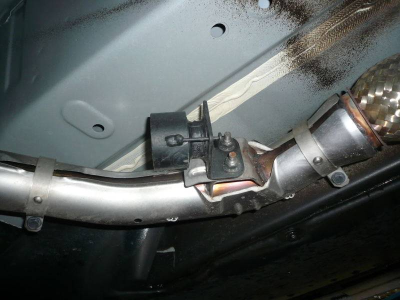

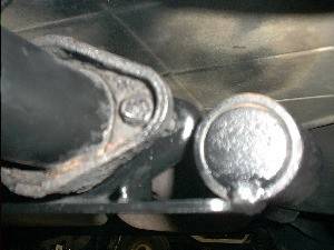

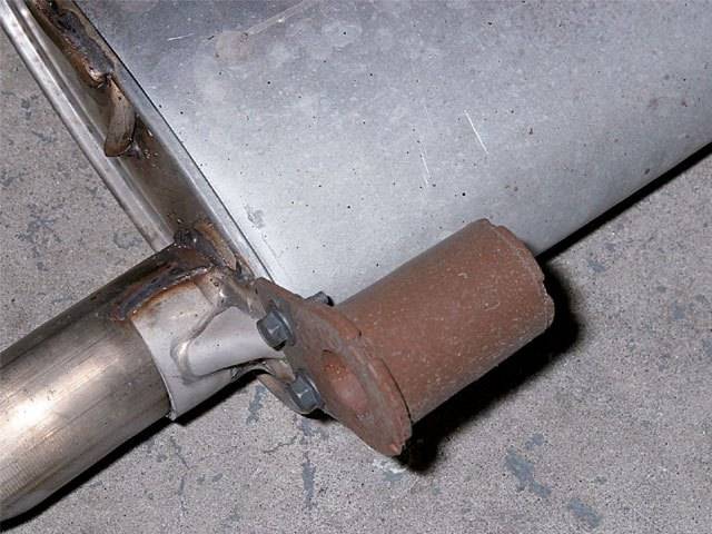

Adding mass to your exhaust system will change its resonance frequency for sure. Manufacturer have been doing it for years and they wouldn't pay extra to add weight on a car just for fun. Here are some examples:
As for your tuning pipe, it will probably affect the sound of your exhaust system, but the droning noise may come from the vibration caused by the moving parts of the engine. So the tuning pipe wouldn't help in such a case (except for the added mass it procures, of course!).
There is still the tedious job of finding out how much weight and where to put it.
I did not even think about a moment arm added with a mass on the end! That could really help.
