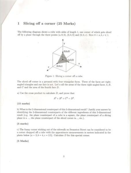

On sheet
I have no idea...i know you guys arent allowed to help if i don't show some working out, but i seriously have no clue how to even start this question :|
please help me

hi man0005! :wink:
tell us what formulas you know for the area of a triangle (with or without cross product ) :smile:
Since there is a reference to using a cross product, can we presume that you know that the area of a parallelogram, having [itex]\vec{u}[/itex] and [itex]\vec{v}[/itex] as adjacent sides, has area [itex]|\vec{u}\times\vec{v}|[/itex]? And, of course, a triangle is half a parallelogram.

ive worked out that the areas of the three right angled faces are
(1/2)sqr root(a^2b^2)
(1/2)sqr root(a^2c^2)
(1/2)sqr root(b^2c^2)
now how do i go about finding D
in order to proof the equation?
what I've tried is to find the length of each side of the triangle and then the height
but I keep getting messy results with lots of square roots :/

isn't that just ab/2, ac/2, bc/2 ? :rolleyes:
ok, now use the cross product method to find area D …
what do you get? :smile:

Is this right for Area D?
i made the line from 0,b,0 to a,0,0 as AB
and the line from 0,b,0 to 0,0,c as AC
so AB = (-a, b, 0)
AC = (0, b , -c)
then using cross product
= (-bc, -ac, -ab)
so area = 1/2 √ (b2c2 + a2c2+ a2b2)

ohh, so you did know the cross product formula? :frown:
yes, that's correct … that finishes the question, doesn't it? :smile:

plane counterpart of a slicing corner would be a triangle? or triangular prism?

because the question starts "What is the 2-dimensional counterpart of this 3-dimensional result?" …
that's what most of the 5 marks will be for, and it's asking for an equation :rolleyes:
so i'd just list all the components of the triangular prism?
okay
so would i say:
cube - square
sliced corner - triangle
sliced plane - line?
then find equation of line?

you need to find an equation equivalent to the original equation for areas :wink:

next, the 3D equation was about a sum of areas squared …
so what would be 2D equivalent of that be?

since the 3D equation is A2+B2+C2= D2
then 2d equation is A + B + C = D?
isnt that what you meant?
D'oh! :redface:
did you read my question …
what are A B C and D?
oh you mean the actual values?
A= ab/2
B= ac/2
C = bc/2
D = 1/2(ab+bc+ac)?
