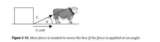

GT1 said:
Does more force really needed to move the box when the force applied at an angle?
Doesn't it depend on the coefficient of friction?
http://books.google.com/books?id=oV... Programmers&hl=iw&pg=PA42#v=onepage&q&f=true
Yikes. They fail to consider that a force applied at an angle reduces the normal force between box and ground and thus the friction.
I hope that bit of analysis is not typical of the book. The parts I glanced at when I saw the book--years ago--looked OK to me. I obviously didn't look at that bit. As always, Caveat Lector!
