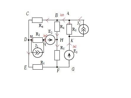

Help me to write Kirchhoff's equations for this circuit. I'd like to think that I do understand this method, however Current sources giving me some problems.
Currents:
Sum = 0For closed loop:
[itex]\sum IR = \sum E[/itex]
Since I am free to choose the currents directions, i choosed them in the picture with red arrows and named junctions and edges.
According to instructions, I need to write (junctions-1) = 7-1 = 6 equations for first Kirchhoff's law. And (all branches-(branches with current sources)-junctions-1) = 11-2-6=3 with second law. (is it really 3?, or some branches should be excluded)
Work:
I start with second law, because I am not sure how to use first one with current sources, I know that using second law, I can't pick contour with current sources.
So I take ABFGA: (I assume that current index is the same as rezistor)
R3*I3 + R5*I5 + I3*R3 = E3
Another contour BCEFB:
R6*I6 + R1*I1 - R5*I5 - R3*I3 = 0
And let's say BCDHB:
R6*I6 + I2*R2 - R3*I3 = E2
Is this is ok?
Please help to write equations for current.(Picture attached)

I would be tempted to turn J2 and R2, and J3 and R3 into their Thvenin equivalents and then write three simple KVL loop equations.
And let's say BCDEB:
correct so far (except you keep writing "3" instead of "4") :wink:
(and yes, there's only 3 loops since the loops with a current source don't count)
first you need to name an extra current between AB (or, easier, is to treat AB as a single point with 4 wires, instead of two points with 3 wires each)
similarly you need to name a current through E2 and E3
then you need a current (KCL) equation at every node (except of course where you're joining two nodes into one, as at AB) :smile:

Ok added currents Iab and Ie2 Ie3. Let's try without joining nodes, I now see that it would be very helpful. (question: we also can join nodes at D and M?)
And what could the 4th contour I am missing, could it be for example: HDEF?
So this is it, I assume positive is the currents that go in, and negative that goes out.
A: I3+J3-Iab=0
B: Iab-I4-I6=0
D: (Do i need to add current I_dm? Or I_dm=Ie2?)
M: (Same thing, I am not sure)
F: I1+I5-Ie3=0
K: Ie3-I3-J3=0
H: I4+Ie2-I5=0
yes :smile:
you're not missing anything …
there are 4 loops, yes, but only three (any three) of them are independent …
if you add the KVL equations for three of them, it comes to minus the fourth, so the fourth one gives you no new information
the number of loops in a diagram (once you've removed the current-source loops) is the "obvious" number, the number of lines you have to cut to make it loopless :wink:
i'm not sure what you mean by that :confused:
positive is the same direction as the arrow, which as you said earlier you are free to choose
A: I3+J3-Iab=0
B: Iab-I4-I6=0
F: I1+I5-Ie3=0
K: Ie3-I3-J3=0
H: I4+Ie2-I5=0
yes, that's correct, but you also need one for node N :wink:
no, Idm is not Ie2
you do need an extra Idm (or preferably make D and M the same node) :smile:
