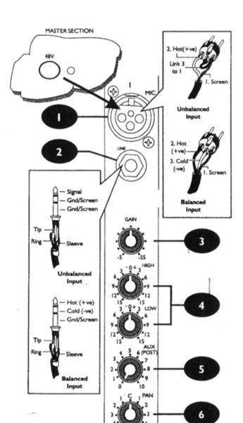

I can't agree with that.
Perhaps you can explain why a balanced jack plug or an XLR connector need three terminals for a single balanced signal?
Note the difference in the extract from these instructions for a professional mixer.
It doesn't need the third wire which I believe is connected to chassis ground at the mixer. It is called a drain and is used to reduce noise. It doesn't need to be there to convey the information from the mic. It is only there to reduce noise usually in the form of 60 Hz hum.
Feeding a dipole antenna with balanced transmission line requires no third wire. A speaker driven with an output transformer is a balanced system with no third wire.
