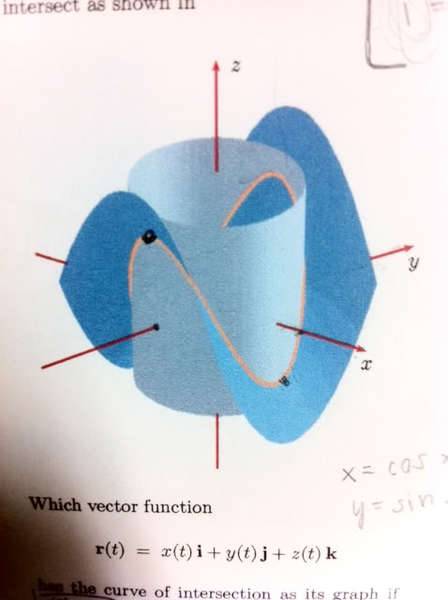

A circular cylinder of radius 1 and the hyperbolic paraboloid, z=y2-x2, intersect. Which vector function r(t)=x(t)i+y(t)j+z(t)k has the curve of intersection as its graph if x(0)=0.
I know that intersection is a circle with a changing z value (the question provided a graph), so my x and y values will either be cos(t), sin(t) or vice versa.

So we have r(t)=<sin(t),cos(t),cos(2t)>
However, this would mean that when y=0, t=pi/2
So when t=pi/2, we should have point (1,0,1), but on the graph provided, the point at y=0 is clearly(positive x value,0, NEGATIVE z value)
I am confused. :/

This is the picture of the graph...
And when I mean a circle, I sort of imagine parameterized curves as being drawn by a moving t value. This t value will go in a circle around the z axis (x2+y2 while simultaneously moving up and down as z increases/decreases.

OK, thanks for the graph Lucci. I have a couple of observations. First, the question should have asked for "a parameterization" not "which parameterization" because there are many that would technically work. And, of course, as I believe you understand, it isn't the graph that is a circle but the xy parameter curve that is. And last, HallsOfIvy's parameterization doesn't satisfy your requirement that x(0) = 0.
Now to answer your question. The parameterization you gave is correct. It correctly parameterizes the unit circle and x(0) = 0 as required. What is confusing you is that your parameterization starts at the y-axis and goes around the other way than what you are used to. Looking down on the xy plane it goes around the circle clockwise. So at t = pi/2 you should get (1,0,-1) as the graph shows.
