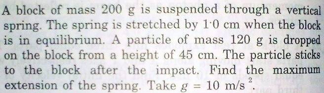

first using the initial extension i found out that k = 200.
velocity of block = √(2gh) = √(2*10*.45) = 3
then using conservation of momentum ...
120 * 3 = 320 * V
V = 1.125
this kinetic energy converts into potential energy of spring
.5 * .32 * V = .5 * 200 * x
x = 4.5 cm
but answer is given as 6.1 cm

You haven't taken into account the gravitational potential energy, GPE is lost by both masses as the spring extents from equilibrium.
[tex] <br /> \frac{1}{2} m v^2=\frac{1}{2}kx^2 -mgx<br /> [/tex]
Thanks for your help ... :)
