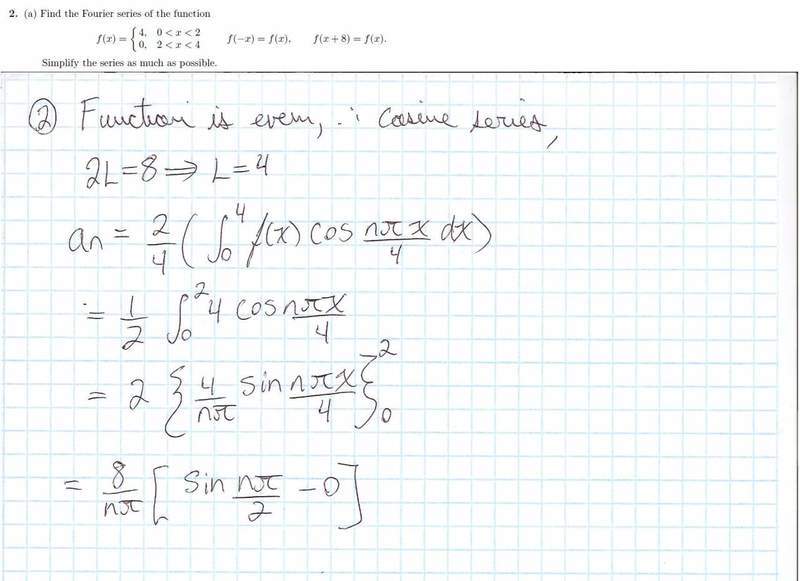

See figure attached for problem statement as well as my attempt.
I'm stuck as to how to rewrite this sin term.
I know that at n = 1 it will be positive, n = 3 it will be negative, n = 5 it will be positive and so on but how can I rewrite this?

hi jegues! :smile:
how can you rewrite sin(nπ/2) ?
well, you're only interested in odd numbers, so call it sin((2n+1)π/2), = … ? :wink:

sin((2n+1)π/2), = (-1)^{n+1}, correct?
EDIT: But wait, the n on the in the denominator on the outside must change as well, correct?
Actually, shouldn't I rewrite it as,
[tex]sin(\frac{(2n-1)\pi}{2}), \text{ because,} \quad n>0.[/tex]
then,
[tex]sin(\frac{(2n-1)\pi}{2}) = (-1)^{n+1}[/tex]
So the whole expression becomes,
[tex]\frac{8(-1)^{n+1}}{(2n-1)\pi}[/tex]

yup! :biggrin:
although easier to use would be sin((2n-1)π/2) = (-1)n :wink:
yes (but i think you're -1 out) :smile:

[tex]sin(\frac{(2n-1)\pi}{2})[/tex]
[tex]\text{When n=1,}[/tex]
[tex]sin(\frac{(2(1)-1)\pi}{2}) = sin(\frac{\pi}{2}) = 1.[/tex]
So when n=1, it better be positive.
So,
I'm not seeing what you mean when you say I'm out by -1?

ah, the original formula was wrong, i didn't notice that …

I'm still confused... Do I have things correct?
i'm confused too :confused:
write it all out again (with the correct formula in the middle), then we can both see :smile:

I checked my answer with my prof. today and he assured me it is correct, but I still don't understand why the red portion I highlighted is included in the graph of the function before applying the Fourier series, can someone clarify? I didn't think the function was defined in that range?
