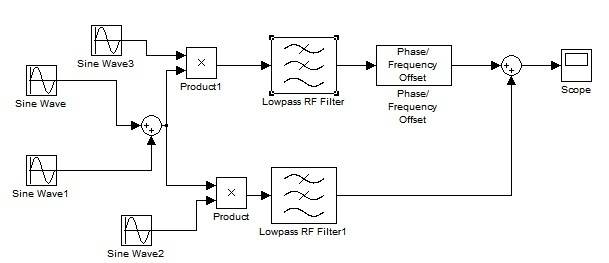

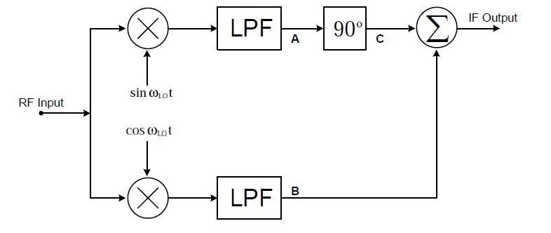

I am totally new to MATLAB. My lecturer wasn't aware of that and just gave us an assignment about explaining the phenomena Hartley Receiver using Simulink.
The diagram is attached as first picture.
Using Simulink, prove that the image signal is alleviated at the output.
Given that input signal, x (t ) = ARF cos(wRFt) + Aim cos(wimt)
The second picture is what I constructed, looks kinda stupid but yeah, can anyone point the mistakes?
