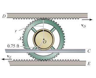

The wheel is rigidly attached to gear A, which is in mesh with gear racks D and E. If D has a velocity of v_D = 5 ft/s to the right and wheel rolls on track C without slipping, determine the speed of gear rack E. Set r = 1.4 ft.
angular velocity of gear [tex]\omega[/tex]= v_D / r_D/IC
v_E = [tex]\omega[/tex] * r_E/IC
where r_D/IC = (1.4 + 0.75) = 2.15 ft
and r_E/IC = 0.75 ft
[tex]\omega[/tex] = 5 / 2.15 = 2.3256 rad/s
v_E = 2.3256 * 0.75 = 1.744 ft/s to the left but it's wrong
What did I do wrong? Please help

hi sami23! :smile:
sami23 said:
… and r_E/IC = 0.75 ft
why 0.75 ? :confused:
(btw, what does "IC" mean?)
IC means the instantaneous center of zero velocity where the general formula is: velocity of a point = angular velocity of the body (cross product) distance of the point relative to the IC for a body having general plane motion (doing translation and rotation).
The distance shown in the picture from the center Point O to the track C = 0.75
My mistake... r_E/IC = 1.4 - 0.75 = 0.65 ft
