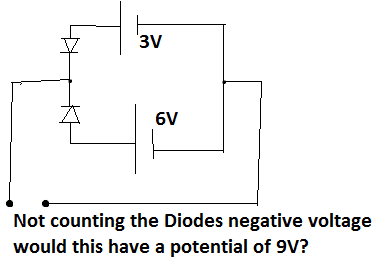

I'm sure you can't but I don't really see why not. Its been ages since I've done anything like this and I just wondered, I can't think of a way to varify it like I don't think you can use superposition theorem.
My question is shown in tha attatched picture.
Thanks very much.

you will get 6V because the top diode will be reversed biased.
Ofcourse! Simple and beautiful explanation.
