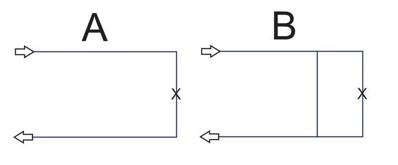

Hi. I used google and found this place. I figure its as good as any to ask this question, which I'm sure forces you guys to dumb yourselves down about 3.14 notches.
And this very well may not be the place to ask this question, so feel free to tell me to sod off if there's somewhere else I should be asking (but please also feel free to guide me in the correct direction if that's the case).
Let's not worry about the "why" if we can... I've simplified this example as much as I could such that if you give me the answer, I should then be able to figure out the real application on my own.
Refer to the diagrams. Let's say these are pipes containing water. A vs B... Question: Is the flow rate of the water at point X in system A greater than in system B ? or the same? Not enough info? Same input, same demand, same pipe diameters, etc... just splitting the path is the only difference.
I'm not a student. I'm certainly no engineer. I'm just trying to figure out something and it occurred to me that there may be something about fluid dynamics that goes against my intuition. My intuition tells me that the flow rate @ X for A is greater than for B because the water crossing X has some going down that parallel pipe in B... but I guess I wouldn't be shocked to find out they're equal.

Not enough info. The answer depends on what you mean by "same input." It depends on how the source will respond to the change. There's an analogy with electric circuits in which the pressure corresponds to voltage, pipe diameter to resistance, and flow rate to current.
By adding the extra pipe you've lowered the resistance. If "same input" means the same number of cubic feet per minute, then clearly the flow at X in diagram B is less, since it gets only a fraction of the water. On the other hand, if the source can respond with more water, maintaining the same pressure as before, then the flow at X will be unchanged.
Thank you. The source can respond with unlimited water for this purpose, so then the flow at X will be unchanged. That's what I needed to know but I didn't word it properly. Thanks again.

Let's use the plumbing analogy with the diagram because actually its pretty close. Say the "input" is city water. Relative to the house requirements, that's pretty much "unlimited" flow and pressure. Let's say X is a meter of some sort (we don't have metered water here but I think many people do so that shouldn't be too unrealistic) and the output is a shower running down the drain. Now let's add a pressure reducer valve right before the shower so that output has constant flow and pressure (because we're assuming everything upstream from there is effectively not a limiting factor). Assuming all pipes are the same diameter and the branch location is close enough to be a non-factor... is X lower in B or the same as A?
Does the system saturate (probably wrong term) such that the flow rate in both branches is constant (whether or not at same pressure isn't relevant to me)? Or does my intuition hold that both branches would distribute the flow evenly between them? Or I suppose a 3rd option that is feasible in my brain... the nearest branch has all the flow and the furthest branch essentially has none as the water takes the shortest path? I kinda doubt that... but I'm not the smart one here :)

Taking your two diagrams the length of pipe from the arrow to the point labelled A in the first diagram and the point labelled B in the second is stated to be identical.
Any fluid that reaches the single or double branch has to transit this length of pipe first.
Flow in this length of pipe is not determined by the subsequent number of branches.
In other words this length of pipe controls the flow into the branches or acts as a bottleneck.
Reducing pipe sizes has not to do with pressure. A plumber will take an inch a quarter feed from the source, reduce it to three quarters after a certain distance, reduce it again to a half inch further down the line. The pressure falls continuously all the way down the line due to pipe friction losses.
Alternatively he might use an inch and three quarter pipe as a manifold with several half inch take offs.
If the input is just a pressure source, the flow at X is lower (but not too much lower) than without the parallel pipe.

It is a simple question if it is defined clearly, but you didn't define it clearly. We need to know about the source of water. One could easily design a system with controls necessary to keep the flow constant in that branch. It's pretty common.
