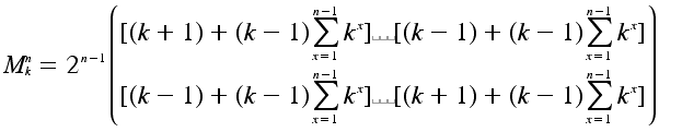

I got the exact same problem, and am pretty sure that there is some relatively 11th grade adequate way to approach this. Maybe something with step 3, where (k+1 k-1) this matrix applies to both the example (2 0) and (3 1)
_________________(k-1 k+1) __________________________________(0 2) ___(1 3)
I really can't find a general equation for the last one in terms of k and n...
Solution??
After some serious work on my last post i came up with this, feedback please!
This is matrix Mk raised to the nth power.
M[tex]^{N}_{K}[/tex] = [tex]\left([(k+1) +(k - 1)\sum^{n}_{x=1} k^{x}] [(k-1) +(k - 1)\sum^{n}_{x=1} k^{x}] \right)[/tex]
[tex]\left([(k - 1) +(k - 1)\sum^{n}_{x=1} k^{x}] [(k + 1) +(k - 1)\sum^{n}_{x=1} k^{x}] \right)[/tex]
(The thumbnail is a lot clearer)
