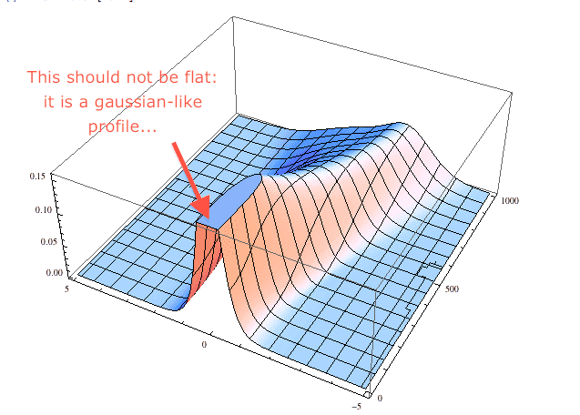

One more question:
When I plot my data in a 3D graphic, it seems that Mathematica "cuts" some data...
I was wondering if its something related to the sample that it uses to make the surface. Do you have any suggestion about this?
Thanks again.

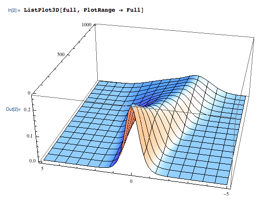

Try PlotRange-> Full Option?
Thanks a-tom-ic !
Now it is exactly like I was expecting!
Cheers.
