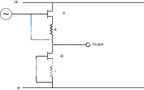

Hi, I'm trying to design a simple differential amp with extremely high input impedance. I'm using a couple of JFETs at the input stage to accomplish this. However, because I'm sending the signal from there to a differential amp, I don't want any DC offset, but I'm a little bit confused about how to bias J1, the first JFET. Basically my question is, should the blue wire be there. Even assuming I am dealing with two JFETs on the same silicon chip, and using the same value for both resistors, if I leave out that blue wire, I get a DC offset. But if I leave that blue wire in, I get almost no current through the bottom JFET and resistor, which is confusing to me. Any insight would be appreciated.
Here is the circuit diagram:

Your blue wire would appear to short the input to the output, no?
Hah, that explains why it removes the offset.
There should be high value resistors from the gate to the bottom of the bias resistor for both FETS. So cut your blue wire and put a 100 K resistor in there.
But wouldn't you drive the bottom one and bypass the gate on the top one?
This would give more gain.
