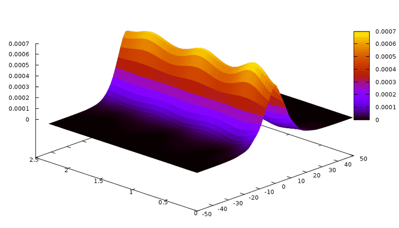

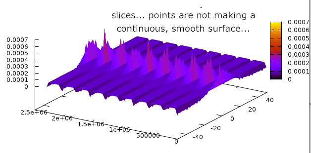

Dear All,
I am using gnuplot to make plots from data files generated using a fortran program. Those data files are basically big lists of 3d coordinates, just like like (not my real data, just an example):
10.0 1.00 0.01
20.0 1.00 0.14
So, when I use splot, I generate plot 1 (attached), and it is ok. But, after that, when I use pm3d ("set pm3d") and dgrid3d ("set dgrid3d 64,64,1", for example), it plots plot 2 (attached), which is pretty different from B]plot 1[/B]: the surface generated is "sliced", and it is not a continuous and smooth surface that it should be.
I have tried to plot with higher values in dgrid3d (256,256,3 and others...), but the problem still happens).
I really would appreciate any help on this :-)
Alexandre

Dear All,
Its me again! I have "solved" the problem, and I will post here what I did (I hope it helps someone someday :)
All I did was to divide the x-values (0 to 2.5e+06; look in plot 2 attached in the previous post) for 1e+06 (in gnuplot I changed column 1 for "($1/1000000)": please see in plot 3, attached in this post, that x-values now are between 0 and 2.5). Now I got a continuous and smooth surface, just as I was expecting to see (based on plot 1 grid of points). Would this be a bug with pm3d function in gnuplot?
Thanks to everybody who read this post!
