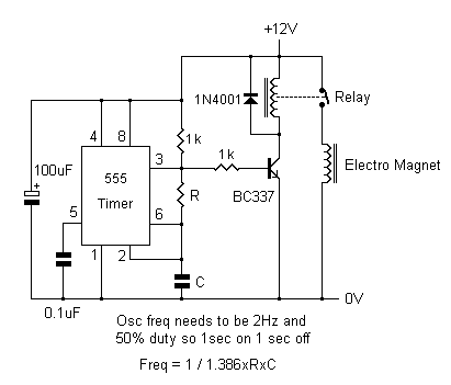

Hello,
I would like to know if there is a part I can buy that will alternate my dc power circuit on/off at short intervals automatically
All help much appreciated,
Cheers,
Nick

yes you could with an oscillator or timer
Tell us more about what you are trying to achieve so we can help you better
Dave

trying to have a electric magnet turn on/off at a regular interval
So the magnet would turn on for a second, then turn off for a second
repeating that indefinitely
ok you could use something like this...
see how you go
cheers
Dave

thanks um, the attachments broken ?
now the only thing you haven't said is what voltage you are running the electromagnet from ?
I have assumed 12V. if its different then the top of the relay contact can be removed from the +12V and the bottom of the electromagnet removed from the 0V and they can be put across the separate power supply for the electromagnet
Dave
