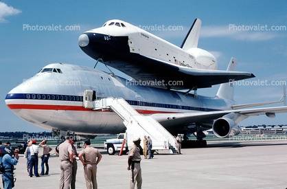

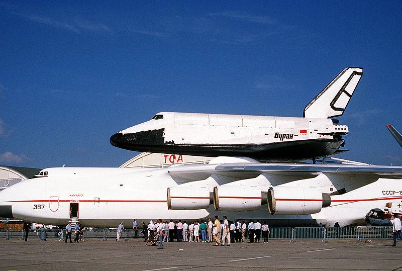

this is what i was noticing , and this is what made me thinking:
note the size difference shuttle to rocket
and now the size difference regular size jet to shuttle
and now imagine the the same thing with a super jumbo jet:
800px-Buran_on_An-225_%28Le_Bourget_1989%29_1.JPE
from what i can tell the plane is bigger then the rocket, you add to this that the fuel you save using the jet engines for initial acceleration about 1000kmh+1000kmh of Earth's rotation and the 1st 15km attitude

There's no possible way to make a jet aircraft both light enough to get into space AND with big enough engines and wings to support several times the aircrafts weight in fuel at a minimum. Yes, you would still need that much to get into space.
