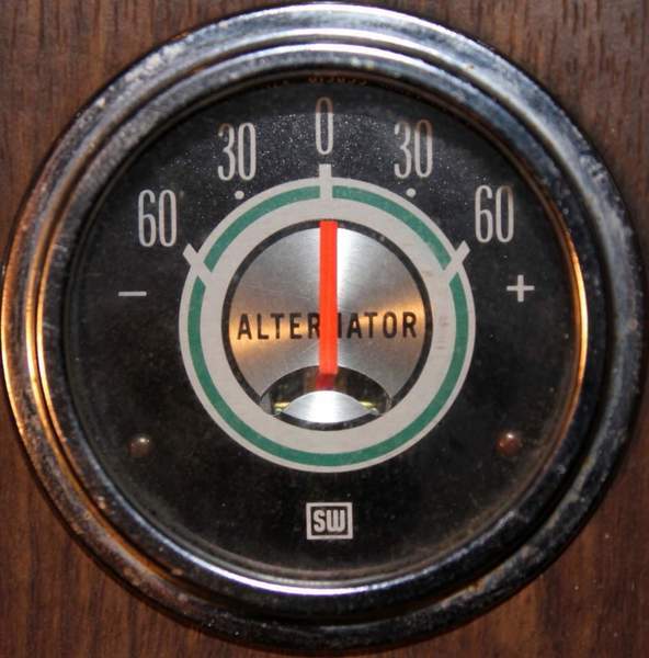

The 1968 alternator gauge is 'smoked' The replacement Stewart-Warner gauge is different - it reads "Amperes" instead of "Alternator". I would like to save the casing on my unit...There is a detent on the rim of the casing and looks to me like the main cap would "pop-off", like a watch case.
If this is rebuildable could you recommend someone...If not, would you know of anyone selling this model...
Any thoughts...
First & foremost, is there any sign of a manufacturer logo, label etc on the original gauge you have?
Second, what make of vehicle or machine is this gauge installed in?

Yes, SW. The gauge is installed in the console (next to the oil pressure guage) on a 1968 Ford Mustang 428CJ FB equipped with a 4 speed manual trani.

Yes, I believe so Fahlin Racing. This is the best I can do picture-wise. This is a Stewart-Warner gauge from the year 1968.
Well, right off the bat, there is no gauge in the catalog like that. Like Mike mentioned, Yearone and other sites that were mentioned by others. I will try just to make sure though.

Q:
Is this alternator gauge rebuildable, or not?...There is a detent on the rim of the face and looks to me like the main cap would "pop-off", like a watch case.
The Stewart-Warner (SW) model is from 1968. If not, I would like to restore this one or purchase NOS (identical to this model).
Q2:
Option- to disconnect my faulty alternator gauge and safely wire up this circuit. How do you connect these 3 wires (live, return and ground)??...

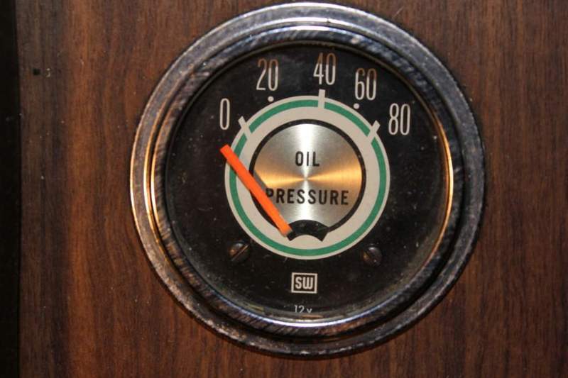

Pictures of -
the alternator
and oil pressure gauges
i would send the amp gage to the link i gave you in California ..have them give you quote on cost to rebuild...
on wiring ..simply connect the to wires from th e amp meter togeather and MAKE SURE you do not connect a ground wire to these two hot wires..also tape the connection so you do not chance grounding it and causing a fire..
and...make sure the wires are not fried, or have melted any insulation off ..be carefulllllllll
