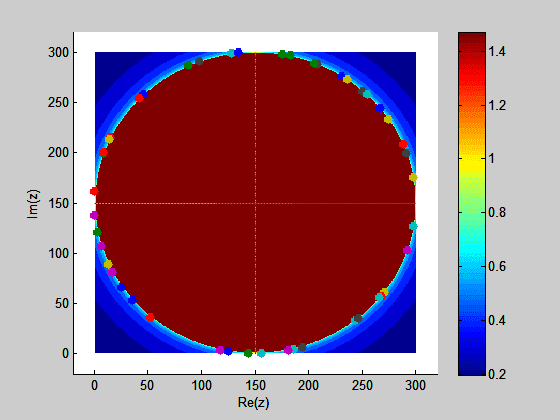

1. I have drawn the julia set and plotted the points to see how they behave on the julia set. But for angles 45 90 they all converge to 0, so f'(z) =0. Isn't this a foutau domain?
2. For points such as pi/3 point oscillate b/w two points 120 and 240 deg.
2. It is written that the behaviour is chaotic for irrational points. can anyone give example of such irrational points on unit circle so that i can look how an chaiotic behaviour is?
Pic attached

Take (cos(1),sin(1)) for example. Or in complex notation: [itex]e^{i}[/itex]. This is a point whose behaviour ought to be chaotic...
Ya thanks a lot . Now I'm not getting any regular behaviour. I have attached the pic
