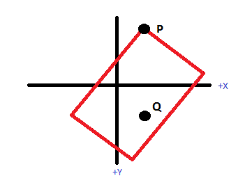

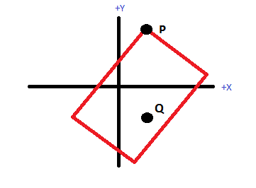

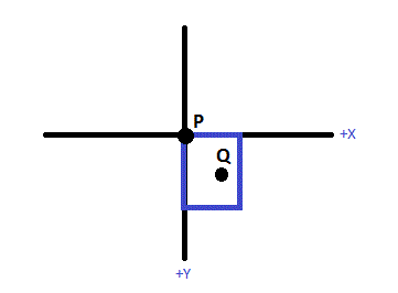

what if i don't know what the orientation of the larger rectangle is, i.e. it could be any arbitrary rotation. in the example i gave (perhaps a poor choice) it is rotated exactly 90 degrees, but it may also be rotated say, only 10 degrees instead. the orientation of the rectangle is an unknown factor in this case (though i guess i could compute that relative to the standard R2 basis vectors).
anyway so if the larger rectangle is arbitrarily oriented about the X and Y axes in 2D space that would require a different transform correct? again the smaller rectangle that i want to map to is always oriented in the same way with (0,0) in the top left corner, +X to the right and +Y down.
i've attached 2 GIFs to try and better visualize what i would like to do.

OK, let's do this in complete generality.
Let's say that your first rectangle is described by (x0,y0),(x1,y1),(x2,y2). And your second rectangle is described by (x0',y0'),(x1',y1'),(x2',y2') And you want to send (xi,yi) to (xi',yi'). Then your transformation should be
[tex]\left(\begin{array}{c} x\\ y\\ \end{array}\right) = <br /> \left(\begin{array}{cc}<br /> \frac{(y_1-y_0)(x_2^\prime-x_0^\prime)-(y_2-y_0)(x_1^\prime-x_0^\prime)}{(x_2-x_0)(y_1-y_0)-(x_1-x_0)(y_2-y_0)} & \frac{(x_1-x_0)(x_2^\prime-x_0^\prime)-(x_2-x_0)(x_1^\prime-x_0^\prime)}{(x_1-x_0)(y_2-y_0)-(x_2-x_0)(y_1-y_0)}\\<br /> \frac{(y_1-y_0)(y_2^\prime-y_0^\prime)-(y_2-y_0)(y_1^\prime-y_0^\prime)}{(x_2-x_0)(y_1-y_0)-(x_1-x_0)(y_2-y_0)} & \frac{(x_1-x_0)(y_2^\prime-y_0^\prime)-(x_2-x_0)(y_1^\prime-y_0^\prime)}{(x_1-x_0)(y_2-y_0)-(x_2-x_0)(y_1-y_0)}\\<br /> \end{array}\right)<br /> \left(\begin{array}{c} x-x_0\\ y-y_0\\ \end{array}\right)<br /> +<br /> \left(\begin{array}{c} x_0^\prime\\ y_0^\prime\\ \end{array}\right)[/tex]

that almost works :smile:
if Q in the larger rectangle is (-x,-y) however, it's coming out as (-x',-y'), which is outside the boundary of the smaller rectangle. though the values seem correct, they are just negated to the opposite (-x,-y) quadrant it looks like. maybe i set it up wrong, i will double-check..
ok, so to summarize the results, the solution proposed by micromass worked (thanks!), but i had to negate the (xi',yi') result for any point (xi, yi) inside the larger rectangle that i transformed. i *think* this is because the coordinate system for the larger rectangle actually does have the y-axis flipped around (see result) such that positive Y points down instead of up (see attached).
does that make sense?
Yes, that makes sense. If you flip the y-axis, then you'll have to negate the result.
very cool.
thank you sir you've been more than helpful!
