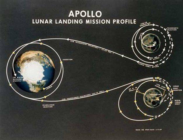

forgetting the need to enter an orbit, is there a difference in the energy required to escape the Earth's gravity by firing a rocket straight up against firing a rocket on a trajectory? Straight up would be a shorter distance.

In that case the Apollo missions come close. They went into a normal orbit using a path that started off vertical, then transitioned into horizontal, similar to the shuttle. After 2 or 3 orbits, they waited for the proper position to fire the engines again to achieve enough velocity to leave the Earth and get captured by the moon (called translunar injection), with a constraint on the time it would take to reach the moon. I would assume that the firing of the engines while in orbit to achieve translunar injection path and velocity was nearly perpendicular to the force of gravity (about 8 degrees from "horizontal" based on the "flight path" numbers included in the article's links). Link to an article I found:
http://www.braeunig.us/apollo/apollo11-TLI.htm
A somewhat related link to Hohmann transfer orbit, which includes the math and efficiency factors to transition from one circular orbital path to another with two impulse cycles perpendicular to the direction of gravity:
http://en.wikipedia.org/wiki/Hohmann_transfer_orbit
Attached is an image of an example Apollo path:
