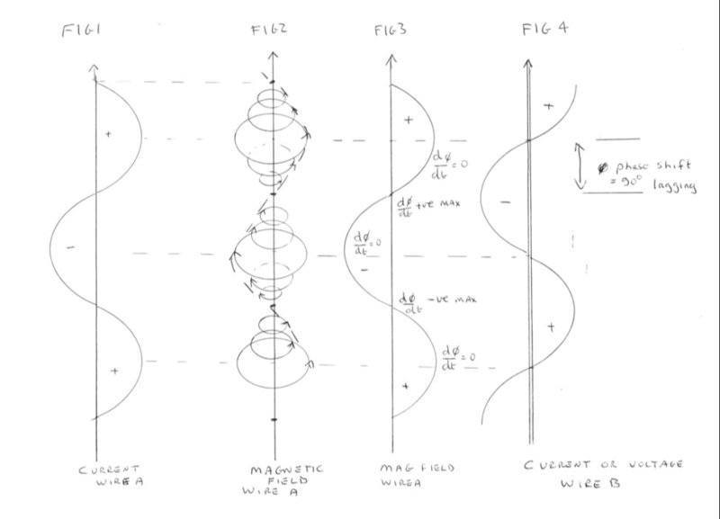

I have not seen exactly this question in textbooks so it is worth examining further.
With references to the sketches.
I have drawn three sketchs showing the situation around wire A and then placed wire B alongside as FIG4. Wire A with the driving current is shown by a single line on the vertical axis. Wire B, with the induced voltage (current) is shown as a double line.
Consider an instantaneous snapshot with the current traveling up the page as in FIG1.
This creates rings of magnetic flux encircling the wire as shown in 3D in FIG2. Note that the direction of the flux reaches a maximum, passes through zero, reverses and reaches a maximum in the other direction in phase with the driving current waveform.
This results in a graph of magnetic flux as shown dashed in FIG2 and repeated for convenience in FIG3. Note these rings are at right angles wire A and therefore perpendicular to a second wire set parallel to A. So they are correctly oriented to induce a voltage along the second wire.
But what of the induced voltage?
The combined Faraday's and Lenz laws tell us
[tex]V = - \frac{{d\phi }}{{dt}}[/tex]
So examining FIG3
[tex]\frac{{d\phi }}{{dt}} = \max[/tex] at the zero points of the flux waveform.
Further the minus sign in the equation says that when the flux waveform is positive going (increasing) we can expect the induced voltage to be negative (in the opposite direction) to the inducing voltage (current).
It is very important to realize that this opposite direction nothing to do with phase.
There are only two directions, up along the wires and down along the wires.
These are opposite and it is this relationship that derives directly from the minus sign the confirms the induced voltage is opposed to (=in the opposite direction to) the driving waveform.
There is also a phase difference of 90 degrees between the waveforms caused by the fact the induced wavorm is the slope or derivative of the driving waveform.
Since the the start of the induced positive excursion takes place 90 degrees after the start of the driving positive excursion it is lagging by 90 degrees.
Both these relationships are shown in the juxtaposition of FIGs 3 & 4.

Thank you for the detailed response. You communicated more eloquently what I was trying to say.
So the induced current does in fact lag the driving current by 90 degrees, which is evident if you compare FIG1 to FIG4 like you said.
In the time domain, this translates to currents that flow in opposite directions when the driving current is increasing in magnitude, and to currents that flow in the same direction when the driving current is decreasing in magnitude.
In other words, a driving current and induced current DO NOT always flow in opposite directions. Please correct me if I'm wrong.

BobS has given the game away, although the clues were all there in my sketches.
I stated, very carefully, that the waves are the state along the wire in space at some instant in time.
So the vertical axes, as drawn, are distance not time. Phase is a statement about time not distance.
I also carefully described the wave in Fig1 as traveling up the page, and showed that the magnetic wave also travels up the page.
But Lenz law states that the induced voltage wave travels down the page ie in the negative direction or against the axis arrow. This is what the minus sign is all about in the differential equation I stated. Not only does it travel down the page but its maxima and zeros are shifted [itex]\pi[/itex]/2 relative to the magnetic wave. This is what is meant by "in a direction to oppose the change". Note again that direction is a spatial characteristic and phase is a temporal one. Lenz law is silent about the phase, you have to work the phase out from the diagrams as I have done or the mathematics as below.
I cannot stress this too highly
In a direction to oppose the change does not mean 180 out of phase.
I stressed it and highlighted it, what more can I do?
Consider a general traveling (sinusoidal) wave
[tex]\varphi = a\sin \left[ {\frac{{2\pi }}{\lambda }\left( {y - vt} \right)} \right] = a\sin 2\pi \left( {\frac{y}{\lambda } - \frac{t}{T}} \right)[/tex]
where phi is the magnetic flux, a is a constant, v is velocity (constant) , t is time, T is period, lambda is wavelength and I have used y for distance since I am using the y axis.
Then the induced voltage, V is
[tex]V = - \frac{{d\varphi }}{{dt}}[/tex]
So differentiating the above expression
[tex]V = - \left\{ { - \frac{{2\pi a}}{T}\cos 2\pi \left( {\frac{y}{\lambda } - \frac{t}{T}} \right)} \right\} = - \left\{ { + \frac{{2\pi a}}{T}\sin \left[ {2\pi \left( {\frac{y}{\lambda } - \frac{t}{T}} \right) - \frac{\pi }{2}} \right]} \right\}[/tex]
I'm sorry I tried to colour the sign and the phase change but my TEX is not up to that refinement so you will have to look carefully.
The negative sign is preserved through the calculation, outside the bracket and plays no part in determining the phase change, which appears as the final term in the line.
As to how the induced current in Fig4 is in phase with the induced voltage, well both wires must have resistance and Ohms law prescribes this.
Finally the elipses in Fig 2 were drawn with an ellipse template, using small sized ellipses. The 'sine' curves were approximated using the pointy ends of one of the larger ellipses in the template.
