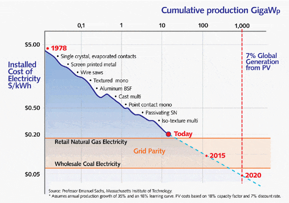

This chart by an MIT solar PV pioneer presents one viewpoint. The "Today" marker was ~2009-10. Note however that the price of NG electricity is also dropping. Indeed, I expect those price lines for both gas and coal could be dynamic if solar starts to gain significant share, reducing the demand for those fuels. The price of solar PV today is http://www.solarbuzz.com/facts-and-figures/retail-price-environment/solar-electricity-prices" (sunny climate, industrial scale) and falling at 1% per month.

The total percent of power production from PV is current only small and still mostly needs some kind of subsidies (or CO2 penalties) to compete, but the gap is closing pretty fast. I think mesleps graph summarizes the situation pretty well, I think within about five years PV solar power will be competitive (maybe even more so for solar thermal).
uart said:
... I think mesleps graph summarizes the situation pretty well,
http://www.technologyreview.com/energy/32383/" :smile:
Agreed, with some caveats: i) until the storage problem is resolved (cheaply) the PV share of the total will likely be limited to 5-20%, ii) add another five years for PV competition outside the sunbelt and for smaller installations.
