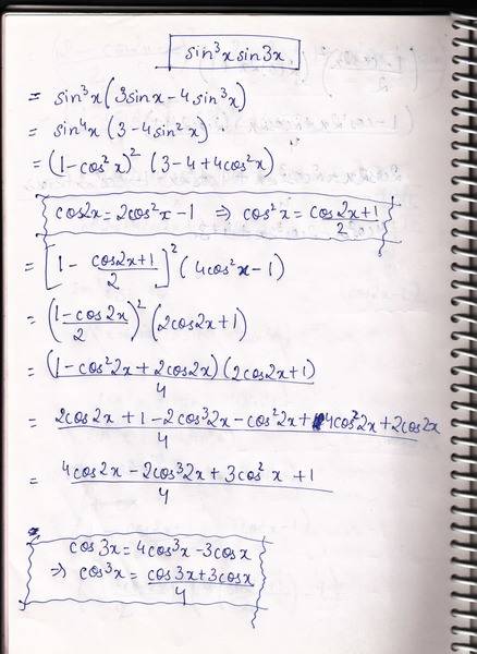

Suppose [tex]sin^3xsin3x=\sum^n_{m=0}{}^nC_mcosmx[/tex] is an identity in x, where C0, C1, ...Cn are constants, and Cn [itex]\neq[/itex]0, then what is the value of n?
I expanded the sigma notation and got:-
[tex]sin^3xsin3x={}^nC_0cos0+{}^nC_1cosx+{}^nC_2cos2x...[/tex]
I wasn't able to think what should i do next?
Please help!
Thanks!:smile:

I tried solving it and got:-
[tex](\frac{1-cos2x}{2})^2(2cos2x+1)[/tex]
Now i am stuck. :confused:

Multiplied and it resulted to be:-
[tex]\frac{4cos2x-2cos^32x+3cos^22x+1}{4}[/tex]
Now what should i do? :confused:

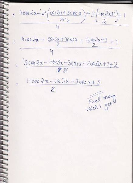

Substituting, i get:-
[tex]\frac{8cos2x-cos3x-3cosx+3cos4x+5}{8}[/tex]
Right..? What's next? :)
Right! :smile:
What was the question asked in the problem again?
Btw, I just used WolframAlpha to check if your current expression is equal to the original expression in the problem, and apparently it isn't.
So I think there is a mistake somewhere.
(Sorry, but I didn't check all your steps individually. :blushing:)
I get something different with WolframAlpha. I'm not sure where the problem is.
(just got up :zzz: …)
the question doesn't ask for the actual expansion, it only asks for the value of n, ie is it up to cos3x, or to cos4x, or …? :wink:
